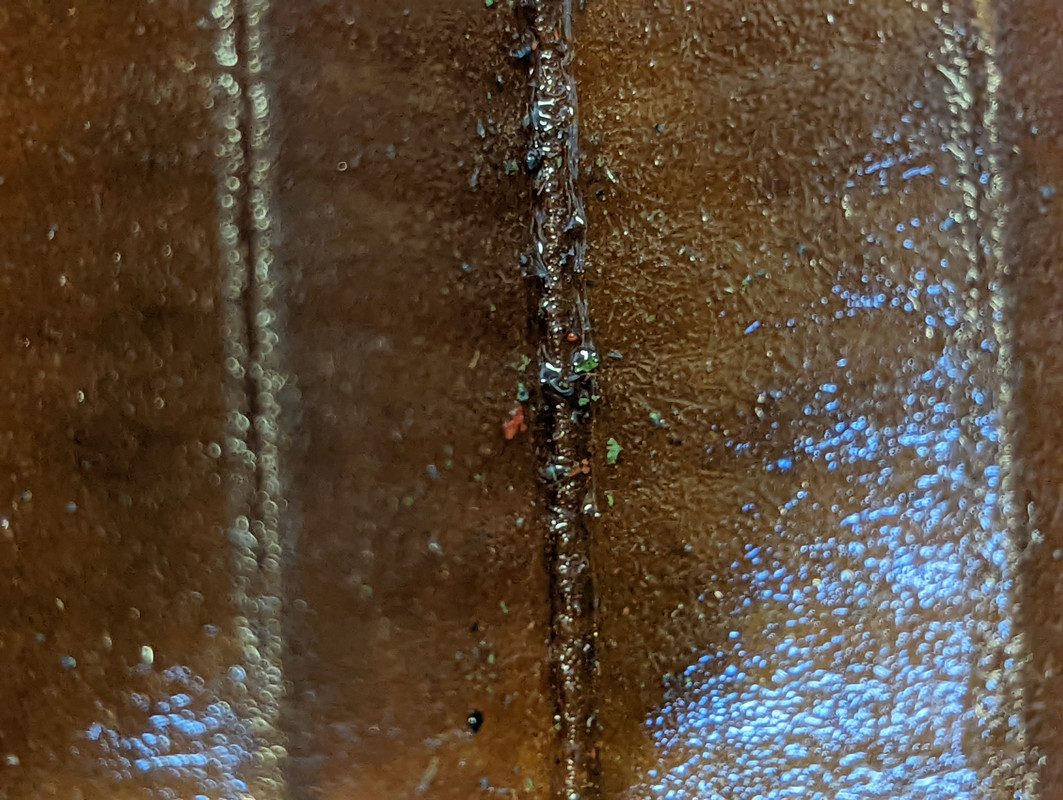

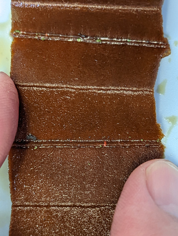

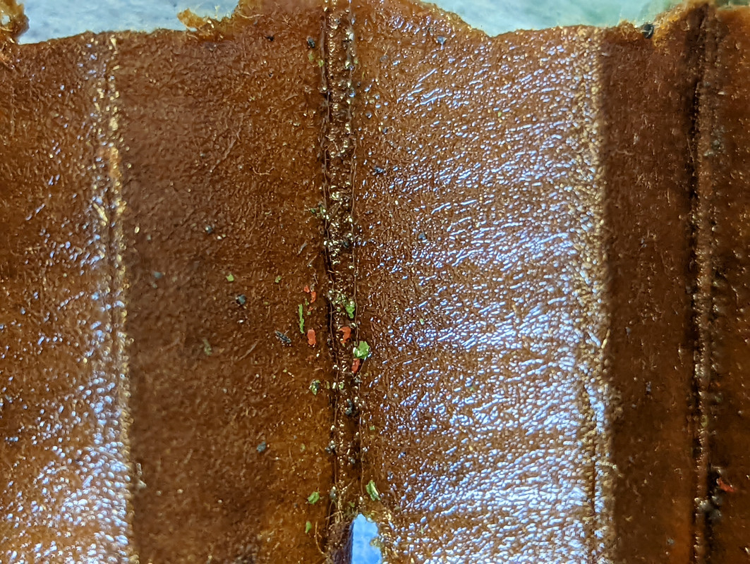

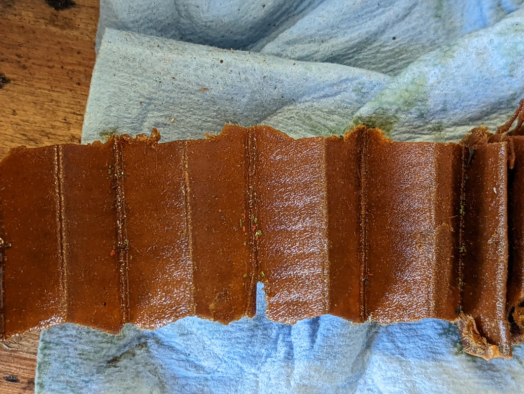

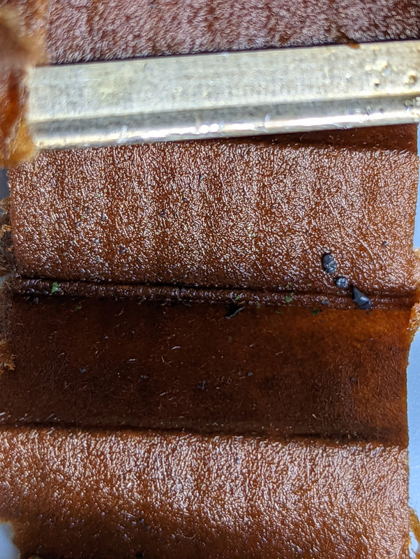

One more datapoint to add. No engine issues, build date 5/22, but I finally hit my break in mileage so I wanted to change the oil. I used a metal strainer when I drained the oil to see if it would catch anything but it was clean. I opened up the filter and found what I assume to be small bits of grey, green, and red RTV.
Thanks for posting this info. Looks like your results are consistent with mine.
I was wondering, though i do not think it's going to work, if it is possible to push the RTV back down towards the pan via compress air through oil filter or engine oil fill hole? But i suspect not since the oil pump is in the way but wanted to confirm.
