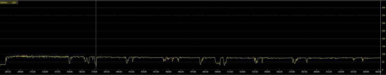

Originally Posted by captain awesome View Post
Haven't watched yet but did you get oil pressure issues under control?
Yes it seems so. Lowest it got was about 20, and I put a 10w-40 oil in it as well. Seeing >80psi at WOT. Logging from the sensor is much improved
Attachment 214591
Awesome man glad to hear it. Also thanks for posting the vid, watching it gets me amped up as hell.
