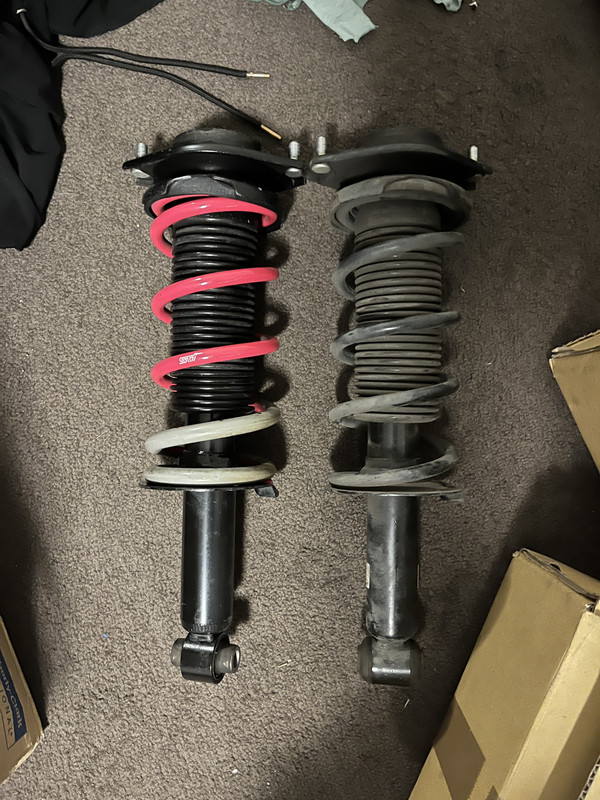

Bump because there doesn’t seem to be a clear answer.
I just picked up a used set of BRZ ts struts with pink springs with the sti branding on them.
Do these offer any lowering of the car compared to stock GTS suspension from an 86, or is the difference purely in the stiffer performance? These aren’t US spec if that makes a difference.
Ideally I’m looking for a 10-15mm drop
What color is the sticker/part number?
Here are some codes you can compare to confirm which strut/country they are from
https://www.ft86club.com/forums/show...=139971&page=7
To really get the most of out them you'd also have to install the supporting STI/ts parts that go along with stiffening the chassis.
You'll feel a slightly sporty/mildly stiffer setup, but it won't drop the car enough to notice. It will still feel mostly stock.

Thanks,
From memory I think it has a blue and yellow marking so going off that it looks like a 10mm drop.
I picked up the whole assembly for under $200 so if the performance isn’t the exact same as the OEM ts with the other sti components then I can’t really complain.

Do you know if those height drops relate to the rear aswel? As there’s no height listed next to the rear spring code. Or does it mean only the front springs are 10mm lower.
I know the stock suspension for my 86 has the rear sitting higher than the front, not sure if these springs are going to make that front to rear bias even worse or if the Ts springs on saach suspension level out the front and rear ride height.
I have blue and yellow marked front springs which as supposedly a 10mm drop, and yellow and purple rear springs which have no drop listed

Blue and yellow is US spec ts springs that came on the ts Sachs dampers. Those are B/Y front and P/Y rears. For height changes, see my previous post. This is the set I took straight off a 2020 ts.

I'm the OP of the complete list. I can confirm that JDM STi aftermarket pink springs lower 15 mm both the front and the rear.
I can't confirm that tS/STi Sport OEM springs lower 10 mm the back too.
In my opinion, looking at photos, no...
