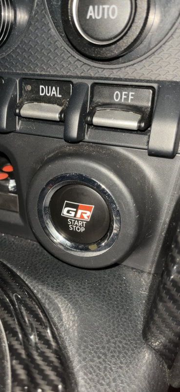

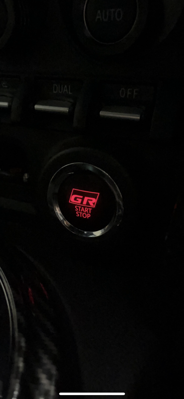

Originally Posted by norcalpb View Post
Please post pictures when you get it all in
I didn’t remove the module or remove the chrome trim piece to do this.
Was a lot harder than expected, the button doesn’t come out easily.
As my tool was broken I ended up using a paper clip and pliers
