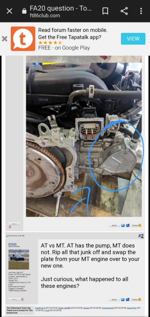

AT vacuum pump. The noise is bang on. It is right back there by cylinder 3.
Cool I was worried because I just got the engine fully rebuilt brand new fully, I'll take some time later when I'm free and look into the vacuum pump. With the vacuum pump are there any symptoms with shifting at all?

I'm guessing it's this spot right here, secondary vacuum pump behind the 3rd cylinderName:  Screenshot_20220513-134745_Chrome.jpg

Yep
