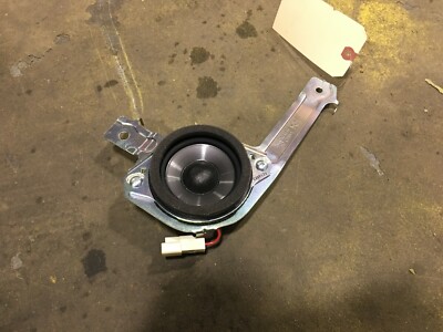

In this picture you can see the connector is mounted to the bracket and then it has leads the run to the speaker terminals. I simply snipped the leads off the OEM speaker and then soldered a short (1in) extensions to each lead and then soldered them to the new speaker. After that I was able to splimpy plug them in.
I also did the same for the front speakers
