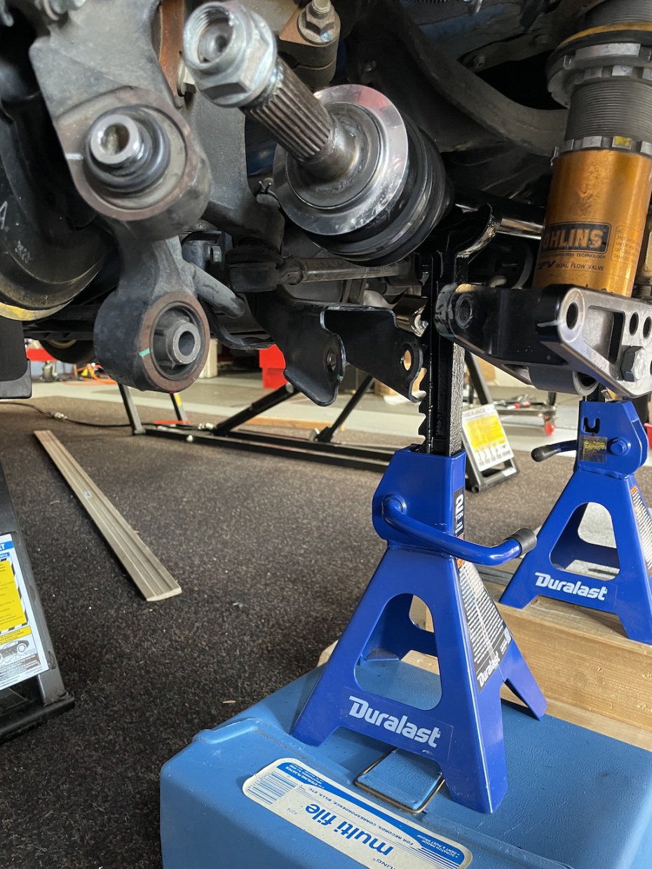

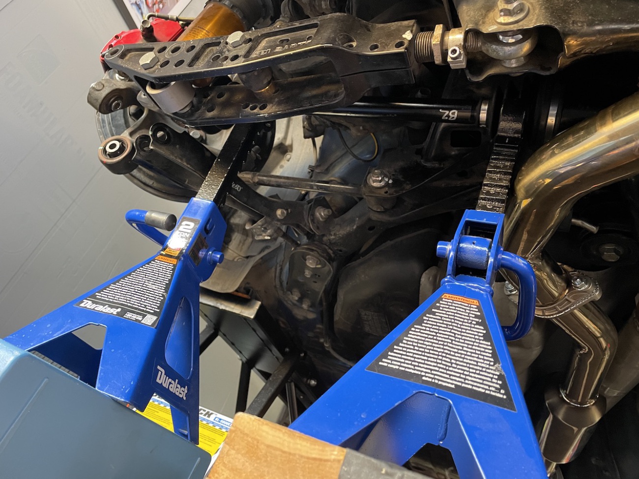

Tip: support the axle.
For aligning the replacement axle:
swivel the spindle+hub to the font as much as possible. Stick a piece of wood between the spindle and the coil-over to keep it out of your way.
I extra jack stands so I used those to support the new axle in a straight line while tapping it into the diff and then wresting the outer edge into the Hub.
Much easier when your're not holding the axle up at the same time!

This was incredibly helpful. Everything went smooth for me until I was trying to hold the knuckle with my shoulder and somehow align it with my left hand while tapping it in with my right.
I didn't have an appropriate piece of wood, but I wedged a rubber wheel chock between the LCA and the knuckle and used a jackstand to hold the axle at the right angle. Then it was just a couple taps and it was in. I liked the thought of using the old axle nut to give a good surface to tap on as well.
