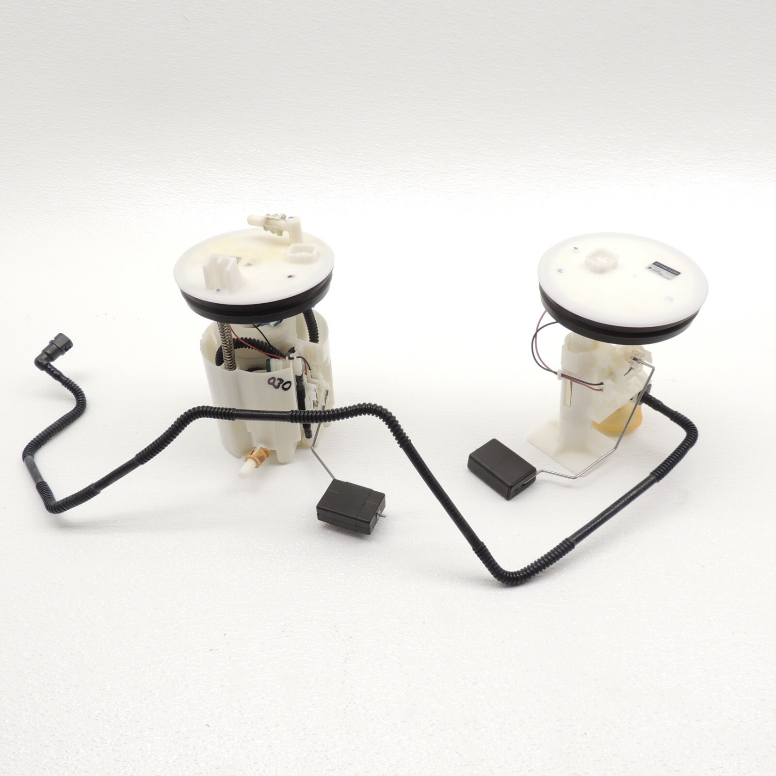

Thanked 16,881 Times in 7,683 Posts
Mentioned: 112 Post(s)
The fuel level sensor seems to be on the passenger side, so if the driver's side is empty where the fuel pump is located then the fuel will read whatever it has, which may be about a quarter tank. The one problem with this theory is that the fuel level at 1/4 tank, but just measured on one side, is only 1/8 tank for the whole tank, yet that doesn't jive with the amount of fuel I put in the tank.
There is a sender on the fuel basket on the driver side as well as on the passenger side tank. I only know since I am working on running two fuel baskets with two pumps and I have an extra basket on my bench.
The Following User Says Thank You to NoHaveMSG For This Useful Post:
Irace86.2.0 (01-21-2022)
Old 01-21-2022, 01:58 AM   #728
Irace86.2.0
Irace86.2.0's Avatar
Join Date: Mar 2017
Drives: Q5 + BRZ + M796
Location: Santa Rosa, CA
Posts: 7,884
Thanks: 5,668
Mentioned: 70 Post(s)
That just looks like a pair of baskets with two fuel level sensors, and one has a fuel pump and the other has a line, but with only two wires going to the passenger basket for the level sensor, it doesn’t appear to have its own crossover pump. You are saying there is a secondary pump?
