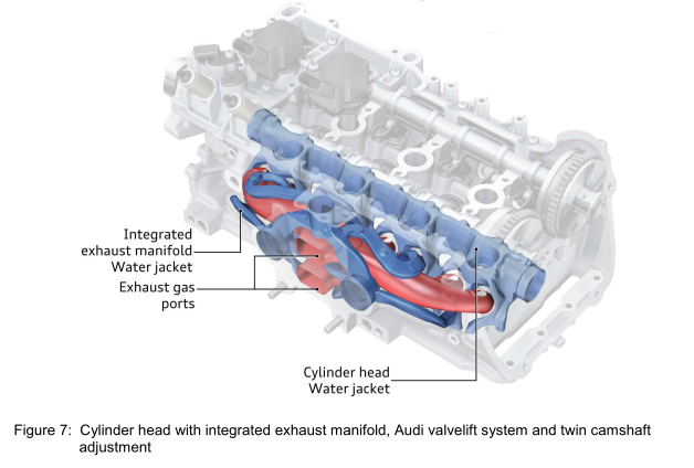

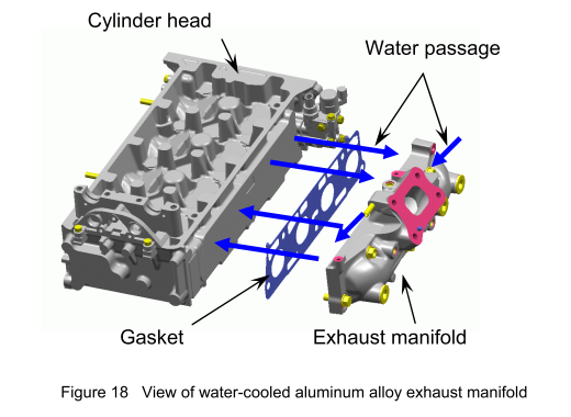

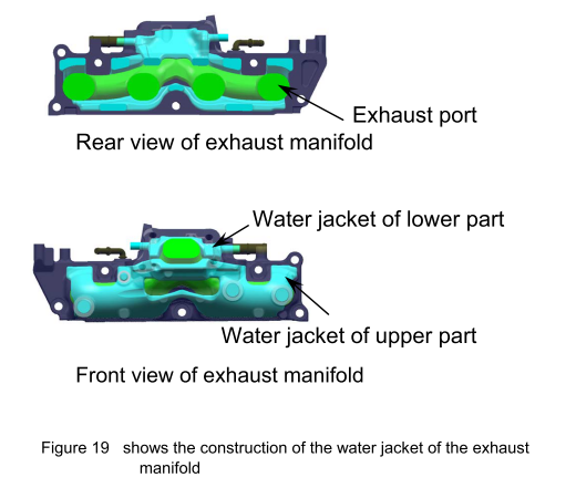

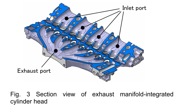

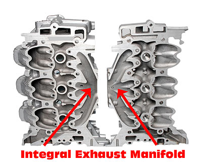

Whoa, whoa... you guys realize there are millions of cars with aluminum exhaust components including turbo engines?
I think that axle-back could be ok for a couple years, but life will get shorter the closer to the motor. But there could also be more stress and fatigue issues with a hybrid stainless/aluminum systems from different expansion rates and galvanic corrosion.
This is a theory that makes sense at first glance, but when you look at real vehicles on the road today it turns out that you've got it in reverse. There are basically zero axle-back exhausts on street cars, but millions of vehicles with aluminum exhaust manifolds. Most of them are cast into the head.
I have four examples for you, two non-turbo and two turbo.
First is the Chrysler Pentastar V6 engine you find in all sorts of longitudinal configurations, like on the V6 Challenger.
next is the Honda R18 engine used in a gazillion Civics
third is the new EA888 1.8T VW engine for European markets that I have discussed in the past. This engine also features port + direct injection like the FA20:
note that this manifold is aluminum and water-cooled. It's also cast into the head. The last example is the Honda K23A1 engine found in the outgoing RDX models. It's aluminum and water cooled, but it is not cast into the cylinder head:
