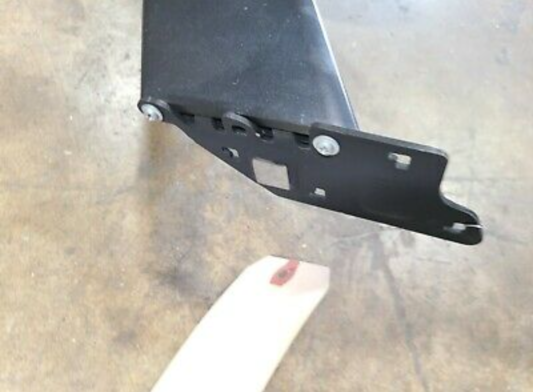

One other thing, did anyone ever figure out how the two outer wings come apart so that I can remove them? In this picture here,
Attachment 206221
it certainly looks as though they are able to be disassembled. If I were to guess, there is an inner and an outer piece that snap onto the center piece and once they are removed, the two screws on the bottom of the spoiler and the two on the end must be removed to complete the removal procedure of the center piece. I'm planning on customizing the spoiler ends. Should I just start prying them off with some panel removal tools hoping that they don't break?
Any advice would be appreciated. Thanks.
The OEM wing endplates are glued on, from memory. I think the only way to remove them is destructive. I ended up removing the entire wing and plastidipping both sides of the endplate while still attached to the main wing. The matte black actually looks pretty seamless since the main wing section is also a semi-mate black.
