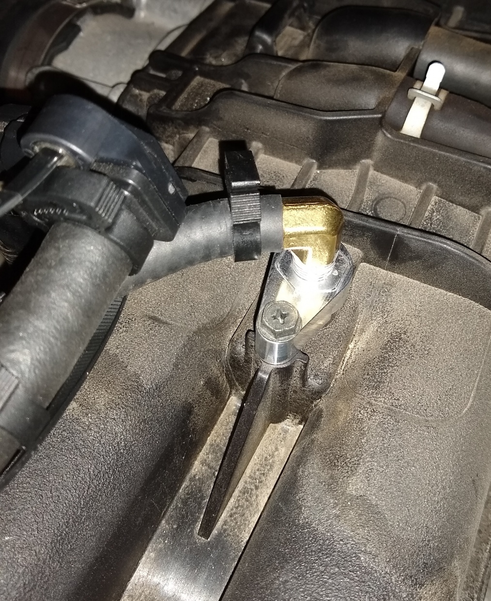

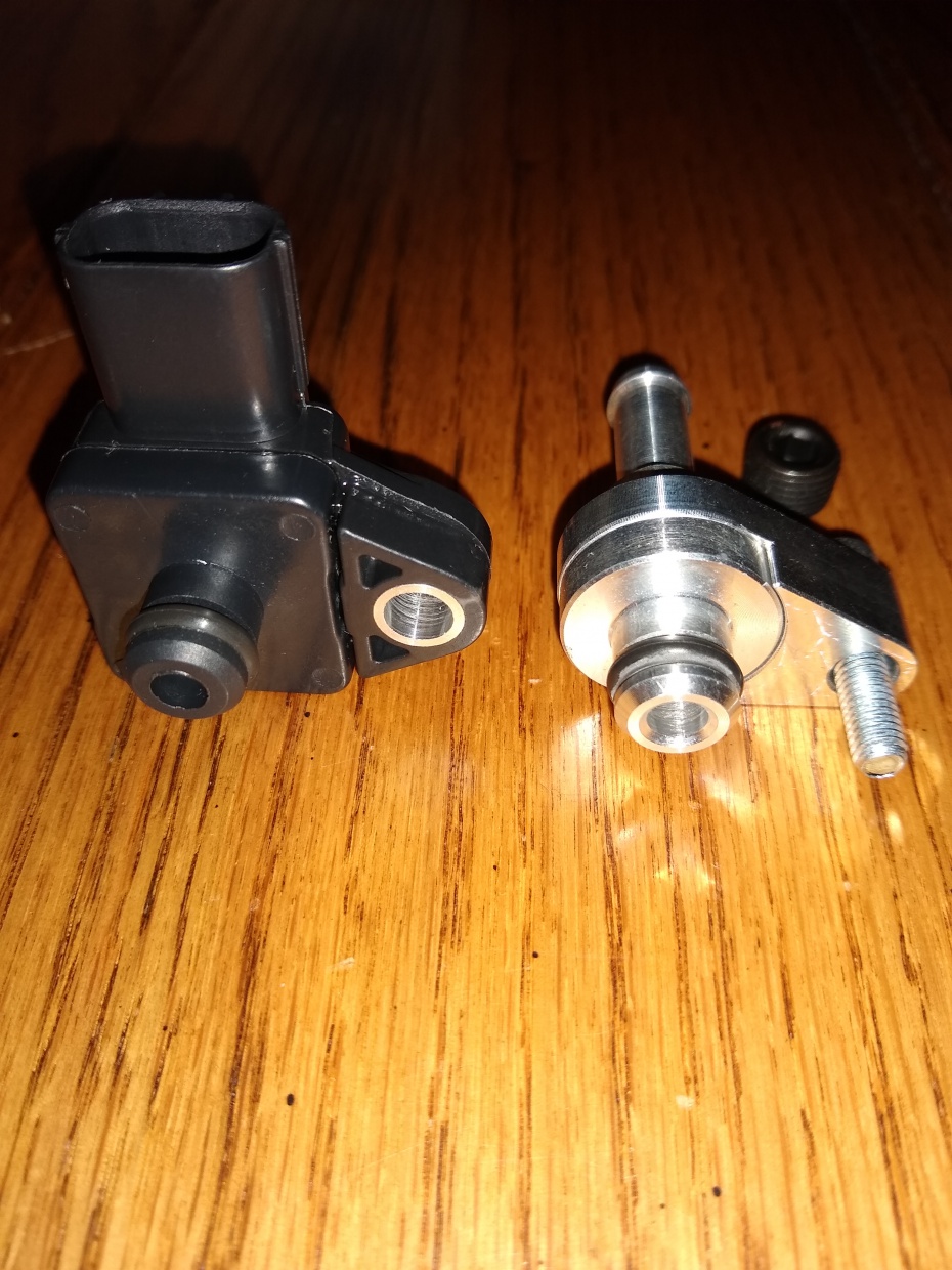

With the proper adapter, you can make pretty much any sensor fit in a remote location.

Whether the sensor you choose is reliable is another story. You are looking at GM part mind you.
As long as you can scale it in the tune and connect the wiring properly, it should work.

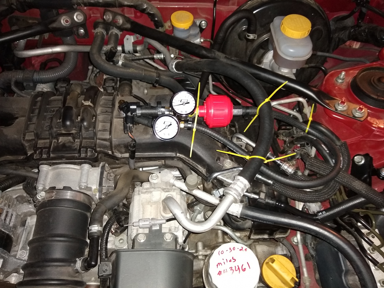

In the application below, I have used an adapter to remotely mount my stock MAP sensor for testing purposes. The gauges are there to check pressure upstream and downstream from the red air filter which I am using as a pressure pulsation limitation chamber.

This is a project that I started quite a while back which I will be testing on my Harrop SC install to smooth out the positive displacement pulsations in order to increase the reliability and performance of the tune.

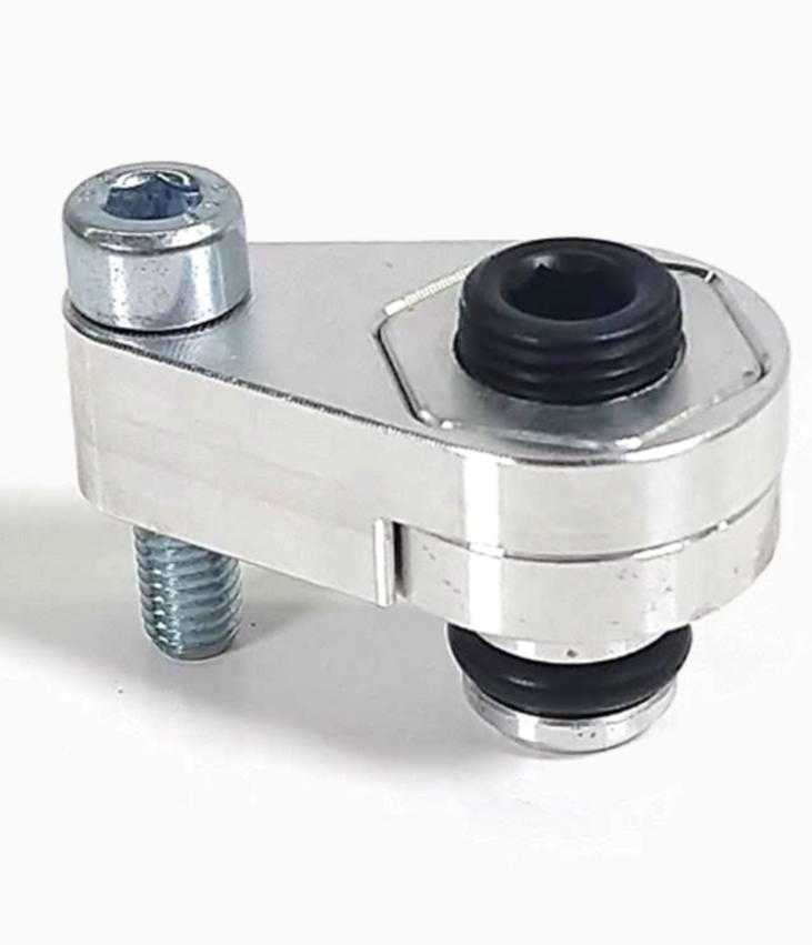

The MAP sensor port adapter that I picked up which will fit onto the stock manifold can be found here:
