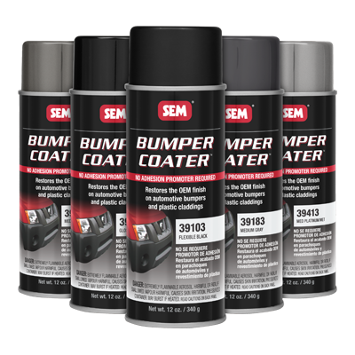

Sand it down and spray it with this.
RayRay88 is offline   Reply With Quote
