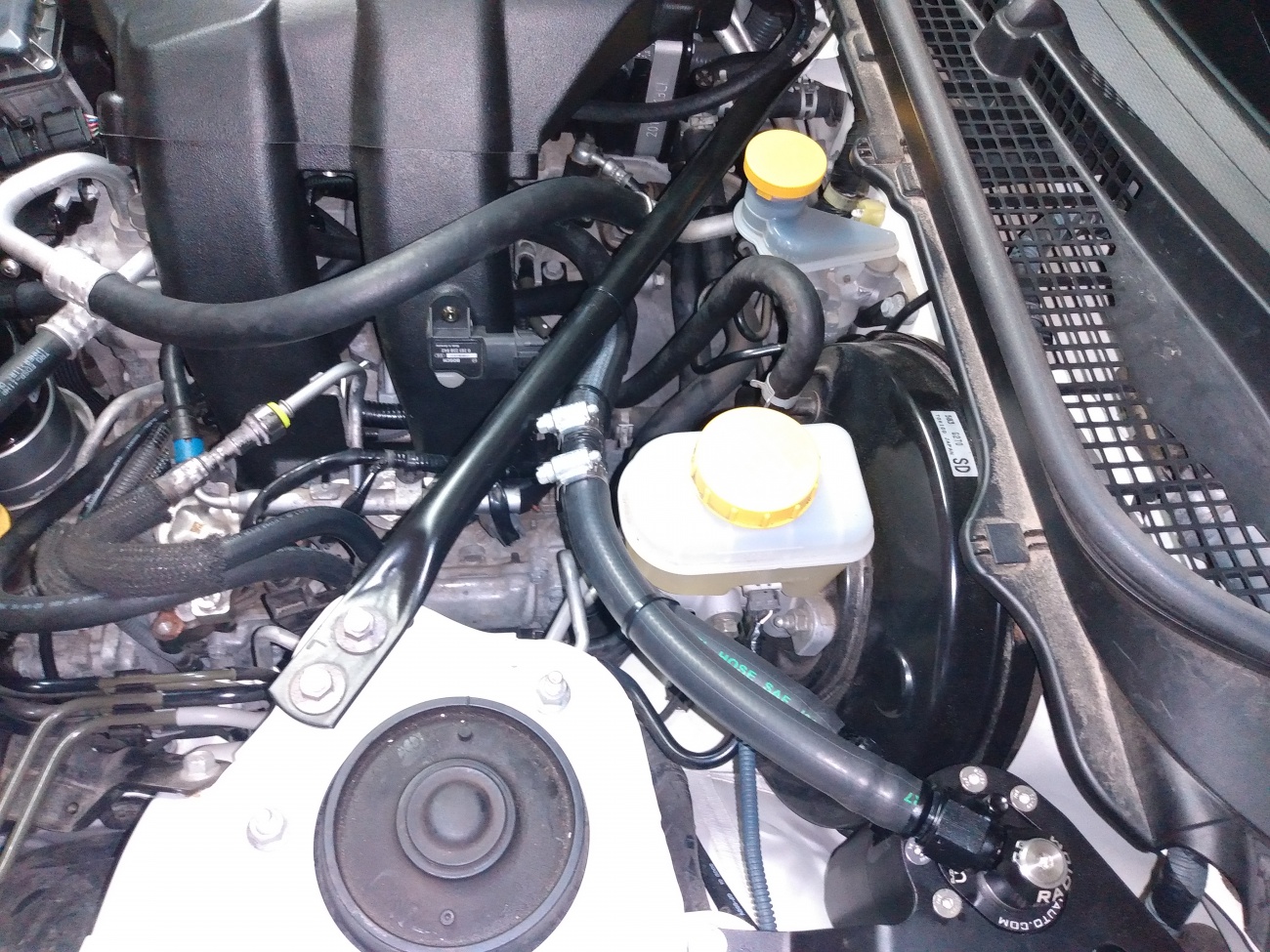

If you have some pics of the PVC catch can install that would be greatly appreciated. Thank you

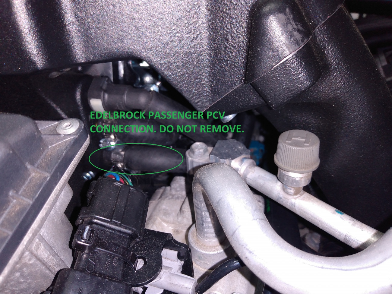

Ask and you shall receive, sir. Attached to message.
tagged for search
'RADIUM DUAL CATCH CAN INSTALL EDELBROCK E-FORCE SUPERCHARGER'
Jerr is offline   Reply With Quote
