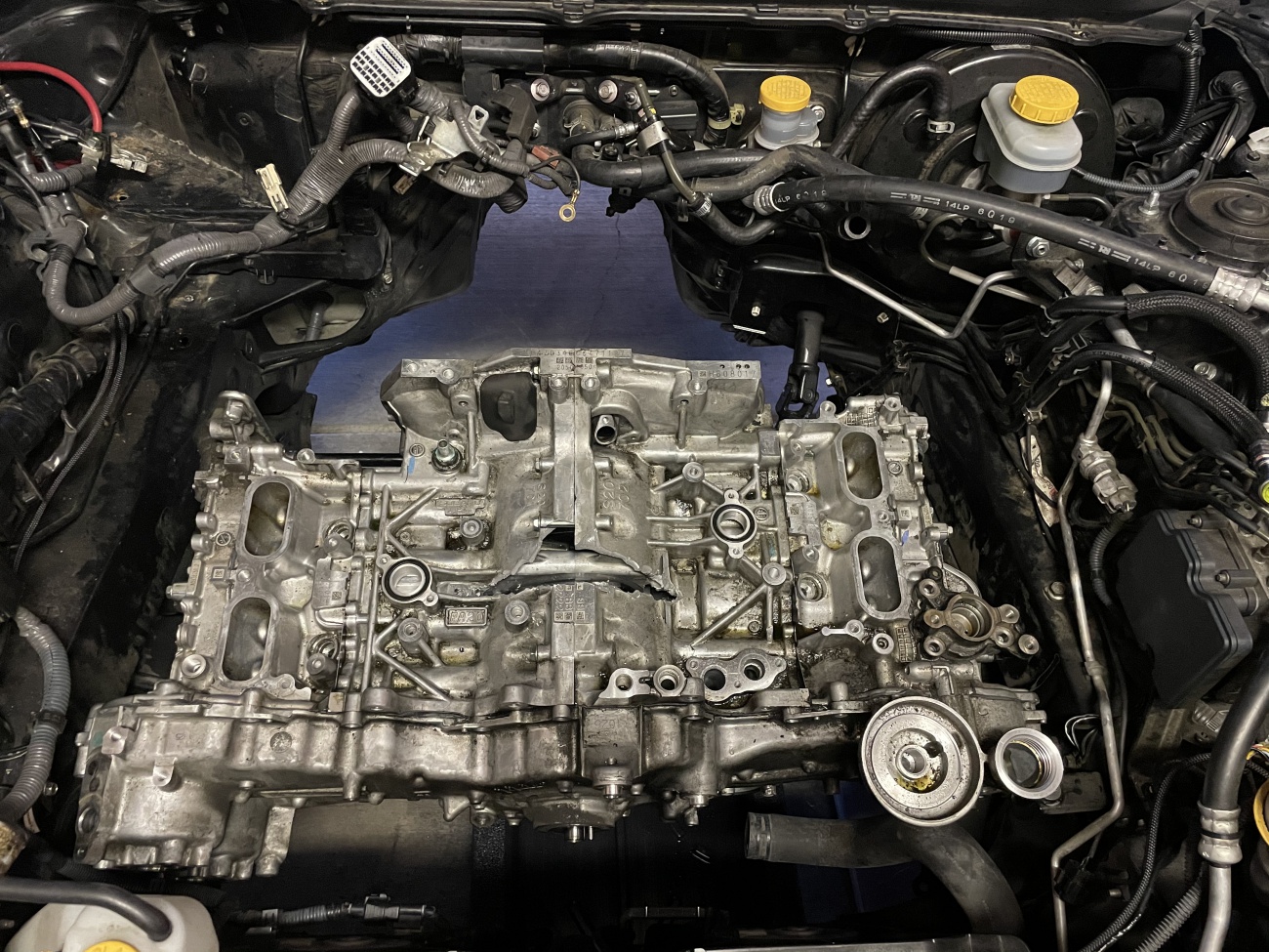

I got a hoist and engine stand. I pulled the transmission and driveshaft today. I’ll be pulling out the engine tomorrow and mounting it. I might pull it apart too if I have time. I’m doing this all from a one car garage that is pretty packed, so it is slow going.
I believe I will have a few days next week to spruce up the parts that I will be selling, but I don’t anticipate anything going on the market until mid May.

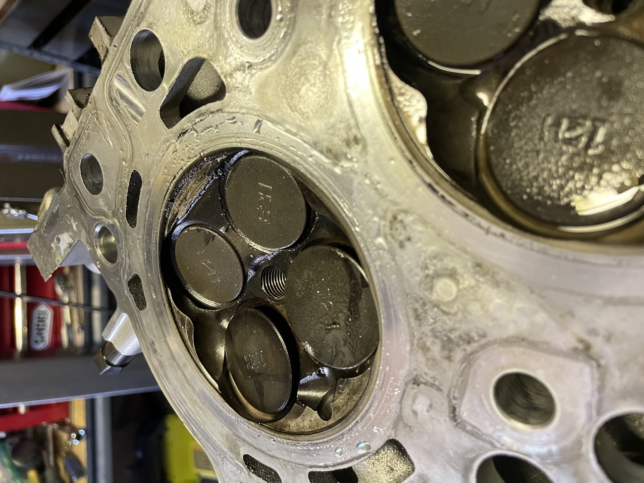

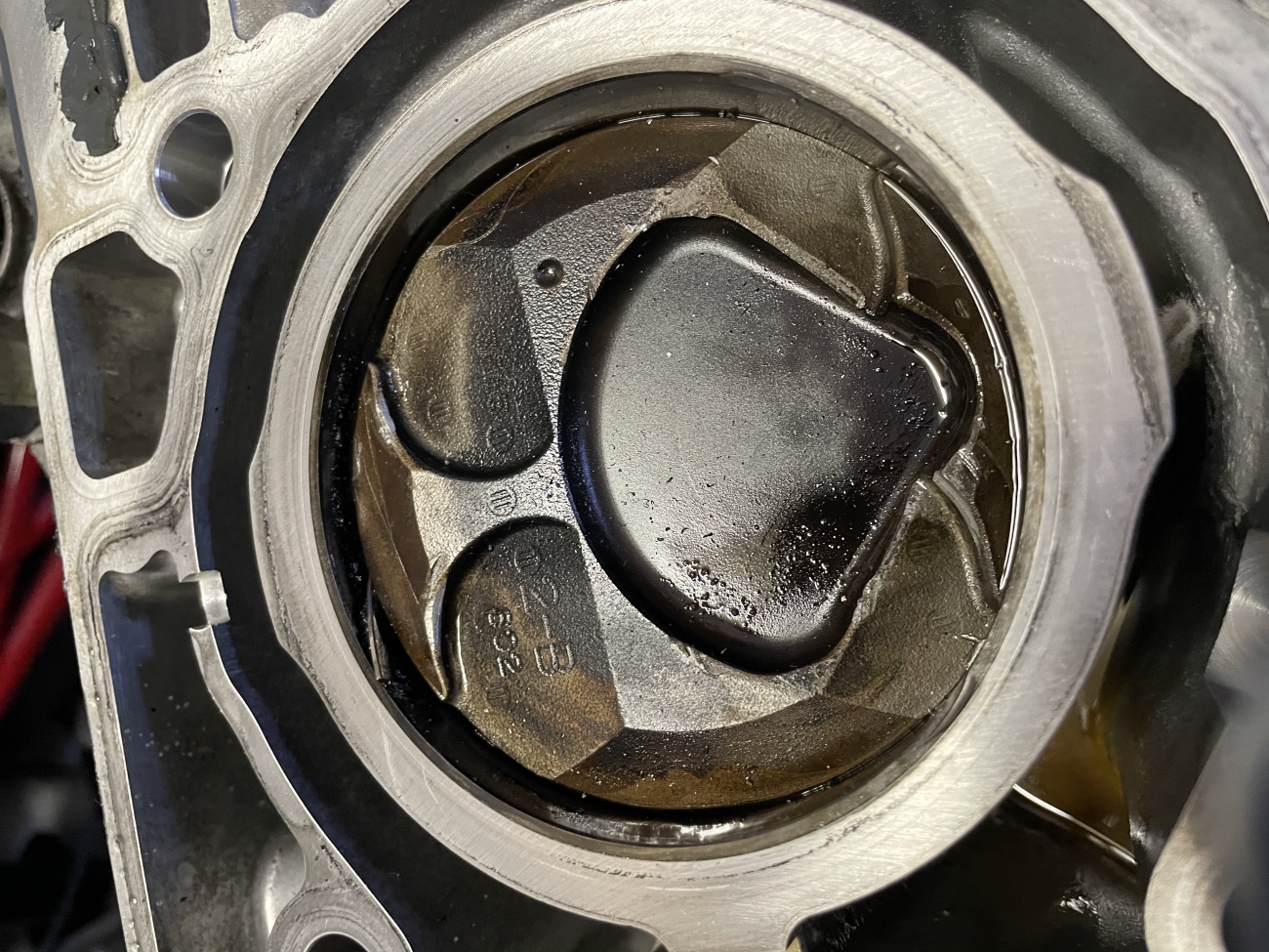

Ok, what came first? The chicken or the egg? Here are some more pics...

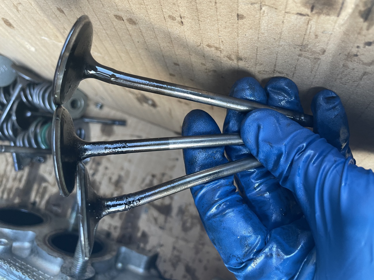

Second cylinder threw the rod, and the roller rockers seem to be missing. Digging further I found the valves bent open. Then I found the number 2 piston rings peeking from the top? Could this have been the grinding sound I heard? I thought it was a spinnibg bearing, but maybe this was it. As you guys can see, the piston is destroyed from the bottom. I still need to pull apart the block, but here is what could have happened:
—My car wasn’t apart of the spring recall, but say something happened and the rockers were thrown, I feel like the spring would have closed the valves, and the rocker would ping-pong around the head, but it wouldn’t cause a problem.
—I drive aggressive, but the car wasn’t being driven too aggressive with the gas, more with the cornering. It had only been running for five to ten minutes from my garage that was around 55-65 degrees is a best guess, as I was heading to work. I wasn’t driving it long enough for ring expansion to happen from heat. Maybe it is possible there was some type of detonation event that cause the ring to overheat and pop out, which is why I heard a pop/bang and then grinding. Then the piston got stuck and the rod ripped itself from the piston, which caused it to spin freely, ripping through the motor and breaking.
—The other possibility is the rod snapped, and when the piston came down, it was struck by the rod, which broke the piston and caused it to impact the valves and twist in the sleeve, causing the rings to grind before the rod sent itself through the block.
Maybe the block will reveal more.

A few more notes, the heads seem good enough. There was one valve guide that broke, but I think that is replaceable. I saved the heads in case anyone wants a cheap head as part of a rebuild. The oil pan is actually fine. It just needs cleaning, but it could be useful for someone needing an oil return welded on. I have the timing chain and guides intact. Everything else was tossed in the recycling because there was no chance of salvaging it because the oil was contaminated with shavings, so surfaces were scratched. The timing chain cover has the oil pump, so I tossed that too.
I get that the glue is probably better than a paper gasket, but screw that stuff.classically, it was partially obstructing holes and sticking near or on moving parts.

my head looked good too but in the end it needed a rectification
Also bent valves, and that bent the intake cam and put stress to the cam gear and the chains and chains retainers... and to other things i do not remember now
I snapped a rod in cylinder #1 though, not saying it s the same for you, just that it needs a very carefull look to evaluate what is still good
Do you have an oil pressure gauge? The rocker failure happens from oiling issues or over revs. Id question the oiling since you have gasket maker on the camshaft but having a piston fly into the valves when you broke a rod would also do it. Which reminds me i need to buy my oil pressure gauge for my new engine
I have an oil pressure gauge. Oil was changed within 100 miles with AMSOIL signature with a new oil filter. Oil pressure was high like it always is in the morning. It wasn’t valve float either because the rpms never exceeded redline, nor were they sustained at high rpms at all. The rockers didn’t have much damage or wear, suggesting they weren’t bouncing around in the head much, and they weren’t in a position to hold the valve open. While it is possible they caused the problem, I don’t believe they were the cause of anything, but a consequence of a piston that was free moving.
When the piston hit the valve and bent them, the spring was unable to retract the valve, so as the cam circled to a low point, the rockers became loose and fell free. That is what is most likely considering the other damage.
If the rocker came free and got stuck in a way that kept the valve open then the head of the piston would have been peppered with impacts instead of just a singled impact, and the valve would probably have been more beat up too, and most like, the valve end would have snapped off and ricocheted around the cylinder. Rod failure of this natured would not be as likely if the rocker was the chief problem IMO.

If it was a rod failure your other rods are likely tweaked / slightly bent. I lost #3 at top of 5th gear, basically an instant rod & piston delete kit.
Post pictures of your other rods when you get them out.
