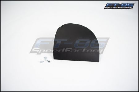

Has anyone made an .stl file for exhaust covers before? I feel like someone would’ve made one in the past by now.
Jchang is offline   Reply With Quote
Old 05-24-2021, 10:27 AM   #133
ybotspawn
ybotspawn's Avatar
Join Date: Jun 2014
Drives: 13 Subaru BRZ
Location: Maryland
Posts: 346
Thanks: 121
Thanked 135 Times in 99 Posts
What do you mean by exhaust covers? Most of the people in here are ringing and designing for plastic based printers, which I’m doubting would hold up against anything exhaust related
Block off plates for those that go single exit exhaust.
