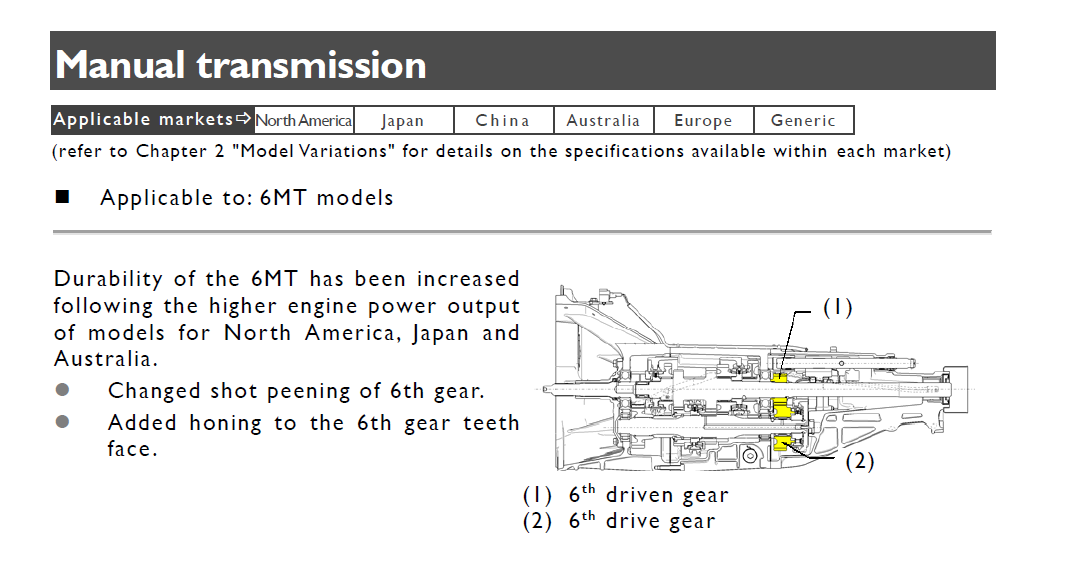

Originally Posted by falcon_wizard View Post
For what it’s worth, I was boosted on a stock block & pump gas up to 9psi, and when I decided to have my engine built, I had asked to maintain the 12.5 comp ratio to keep low end throttle response even if it meant a lower top end at the end. As DD reliability was a key goal for me The builders/tuners indicated they could do it, but strongly advised against it to keep some safety margin, so we ended up going for 10.0 CR. E85 is not readily available in my area, best I have is 94 octane. I think the build ended around 21/22 psi on HB. So it will interesting to see if the R&D on the new gen FA24 will find ways to reliably go beyond milder boost levels on a stock block when E85 is not available. nitro possibly ? However unless the tranny was also beefed up (I am not aware that it has), then that will remain a weaker point once you go beyond that anyway. My sense is that there will be more people that sit perfectly happy with a tune and some bolt ons without FI than on gen 1, and the bolder folks that do go all out, well they will just continue to do so... :-)
Though it may have been fairly useless, gen1 "beefed up" the tranny 6th gear for the "additional power gains" in the 2017+ models, which was all of 5 HP. I'd like to guess that with a pretty solid torque increase, they would have had to do some kind of modifications to the current trans.
It would be great news indeed if it was further beefed up...
No doubt they will have to do something to keep the margin for error about the same but the 2017 "improvements" were far from earth shaking!
I agree haha. That's why I have no high expectations yet. The only real conclusion I can make here is that they will definitely modify the current transmission based on the power increase. How? We will see. But the stock tranny was impressive enough for a 200 HP car. Not too unusual, though, as it was used in the MX-5, RX-8, and others that weren't high powered monsters.
Subaru doesn't go crazy with their WRX trans, which has limits at around 400 wtq from what I've read. This isn't significantly different from the limits of our trans, and the wrx has a LOT more torque. Now I know that isn't an apples to apples comparison, it just makes me think that to save on cost, they might have some minimal updates to our trans as it can handle plenty to begin with.
