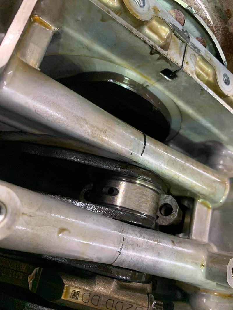

I did speak to the dealer that fucked mine up a second time and they said they'd be happy to tear it down and see what went wrong but I would need to pay the $1600 teardown fee before they started. They also said that I should expect to be buying a new engine because it is so far outside the 12 month period now even though when I first called it was only 13 months back in August. Just getting the car to them would cost nearly $200 so I'd be on the hook for $1800 and they're backed up until February so it has to sit in my driveway for another 4 months. I'm going to end up throwing the damn thing out for scrap value soon because nobody seems to want it and that really sux, I can't keep it in the driveway much longer because I don't want to keep paying for insurance and it's time to reregister it anyway. Can't take the plates off, which means I can't take the insurance off, because my town doesn't allow unregistered vehicles to be stored on residential properties and the only place I have to keep it is the front of the yard along the street where it's really obvious it's not registered and the snowplows will eventually clip it anyway.
Fuck Subaru and their shitty service.

That doesn't look bad. Were the o-rings on the timing cover in place? Not distorted? If not properly seated on assembly, they pop out under pressure.
I didnt get pic of the timing cover. Just got these pics. Not giving me much info or being very direct in terms of cause.
