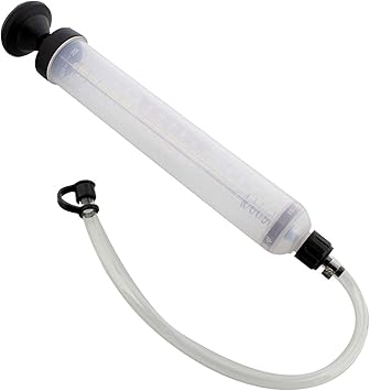

Interesting! I was getting tired of jacking the rear of the car up to check the oil. Also, may I ask how you checked the oil? I find that my dipstick has a hard time being able to show the level of it, so I've been using a Syringe like this one.
But that gets tedious as well since the hose will always trap some oil in there. Might just go back to the good ol' dipstick way.
Geez mate you're dedicated! That sounds like quite the mission every time to check the level!
I also found it very difficult to read the level on the dipstick the first time I tried to check. I ended up using a combination of tips from Bullet and I believe someone from this thread. As soon as I unscrew/remove the dipstick, I hold it horizontal and rest the top/dry end on the edge of a paper towel. Then, slide it across the paper towel moving toward the bottom/level notch. You should then be able to see more clearly when the oil makes contact with the paper towel in relation to the level on the dipstick. I find this method works best for me but you could also simply place the horizontal dipstick on the paper towel and see where the oil marks the paper for your reading.
I hope my explanation was clear enough and not too confusing!
Make sure you wipe the dipstick clean first before doing this. Also, be careful to hold the clean dipstick as straight/steady as possible when screwing it back in and out, to ensure you don't pick up any oil along the dipstick from the housing/threads etc. In saying all that, I have found that if the dipstick is hard to read, then it generally means the level is too low. Once the level reaches the mark/notch it will collect there and should be easier to see.
