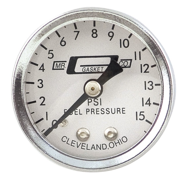

100 psi, 10 psi, you can see that their gauges go down to 0 psig and up to 300 psig, a pulsation is a pulsation. Water, air, they’re both fluids, and with the exception of liquids not easily compressing, they will both act similarly.
I don’t think we would have to make any modifications to the supercharger at all. We just need to find the right materials and adapter fittings to fit. I’m going to start working on this. I can probably source all of the components needed close to me. I’ll test it using two of these:
One gauge right out of the MAP sensor pressure port on the supercharger, then through the dampener to the other gauge right at the MAP sensor. I’ll post my results but I may create a new thread dedicated to this project
I see no reason why this shouldn’t work. And if it’s less than the cost of a D-Box, then it will will pay off in the end. Remember that the D-Box needs to also be tuned into the ECU to function properly. This won’t have to be.
Attachment 193407
1) It's damping, not dampening. You're not making it wet, your slowing the rate of change in a system.
2) You can accomplish the exact same thing with a basic needle valve. As it would need to be mounted to a car and you wouldn't want it to rattle, a pneumatic flow control valve that can be locked in position would be perfect. Something like this would likely be perfect for a remote mounted MAP sensor. https://www.grainger.com/mobile/prod...fc=MWP2IDP2PCP
But even just a remote mounted MAP sensor with a few feet of tubing would probably give enough damping to fix the issue.
Alternatively, while I haven't seen the dbox, I've filtered noise from control signals in the electronic realm as well. A simple first order low pass filter set to filter above say 400Hz would likely be sufficient. You can find calculators online easy enough.
1) I think dampening works. Just saying.
2) I like the idea of mechanical dampening. While a two foot tube could work to alter or disrupt the resonance, it seems like the waves could still propagate down the tube, no different than an instrument.
Yeah, I've seen dampener and damper used synonymously.
(Trying not to make the "Grammar Nazi" comment.)........Whoops, did I say that out loud?
In all seriousness, I'm sure there's a few ways to smooth the pulsations, each with their different advantages and disadvantages. Experimentation will lead to results.
