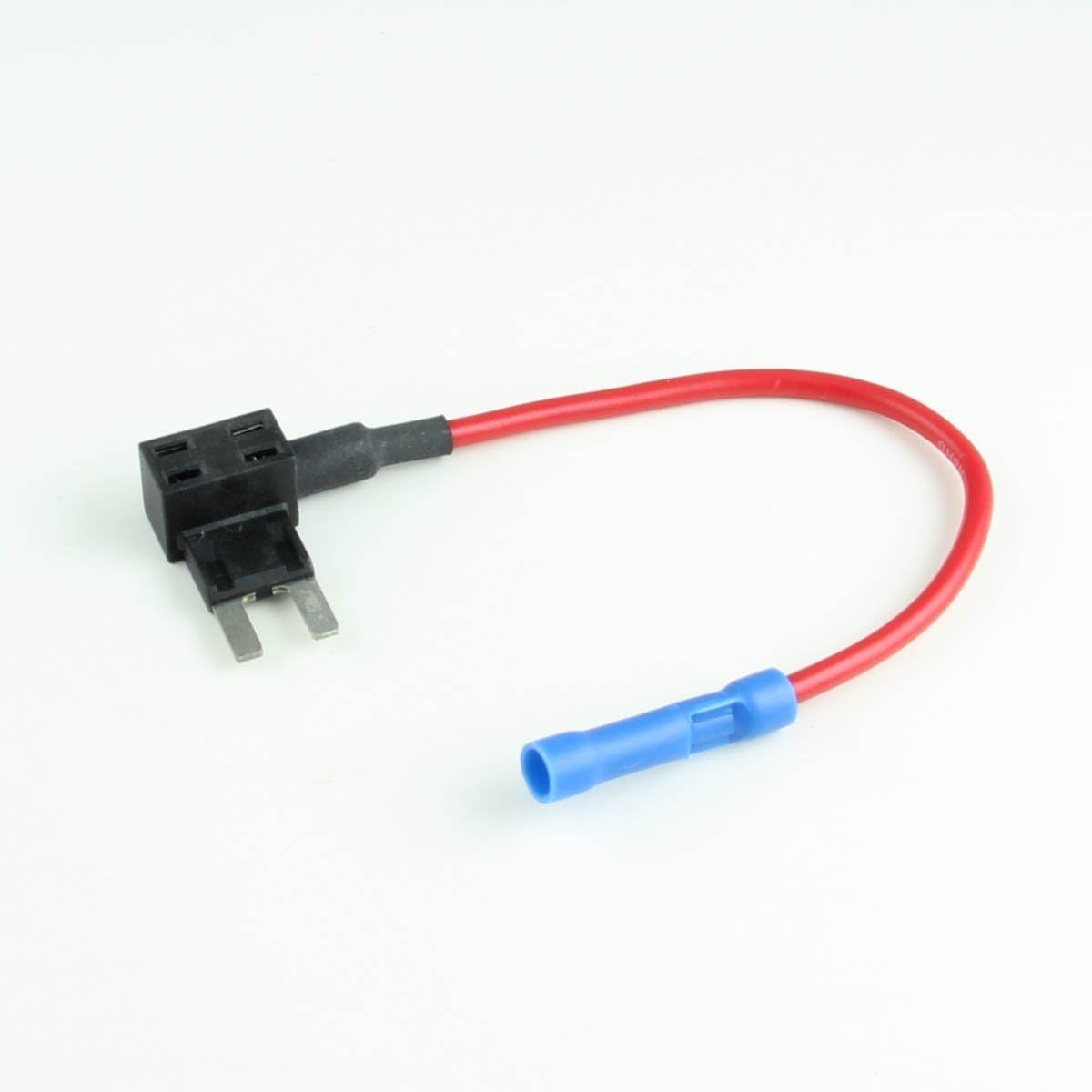

You could do some wiring to enable boomerangs to stay on as DRL. Determine on the harness what wire operates boomerang, and solder a wire from DRL wire (vland) to DRL wire in bumper (brown).
I did this for my OEM headlights (2015) when installing switchbacks.

I ended up soldering an extension cable to the white wires and running into the fuse box. Those white DRL boomerangs are on when the car is on.
