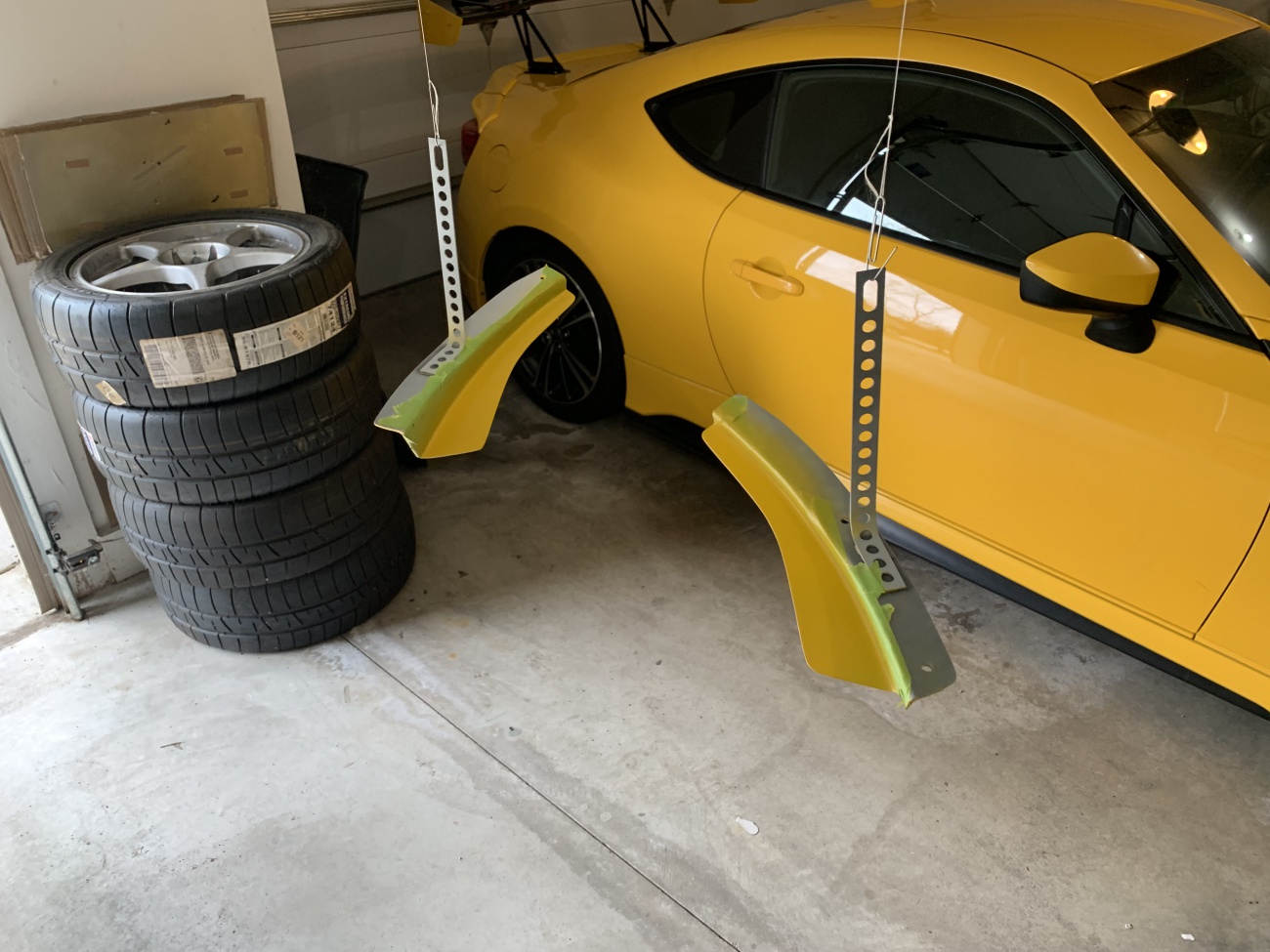

Some more front end downforce to balance to diffuser. These are ACE canards, painted to match.
