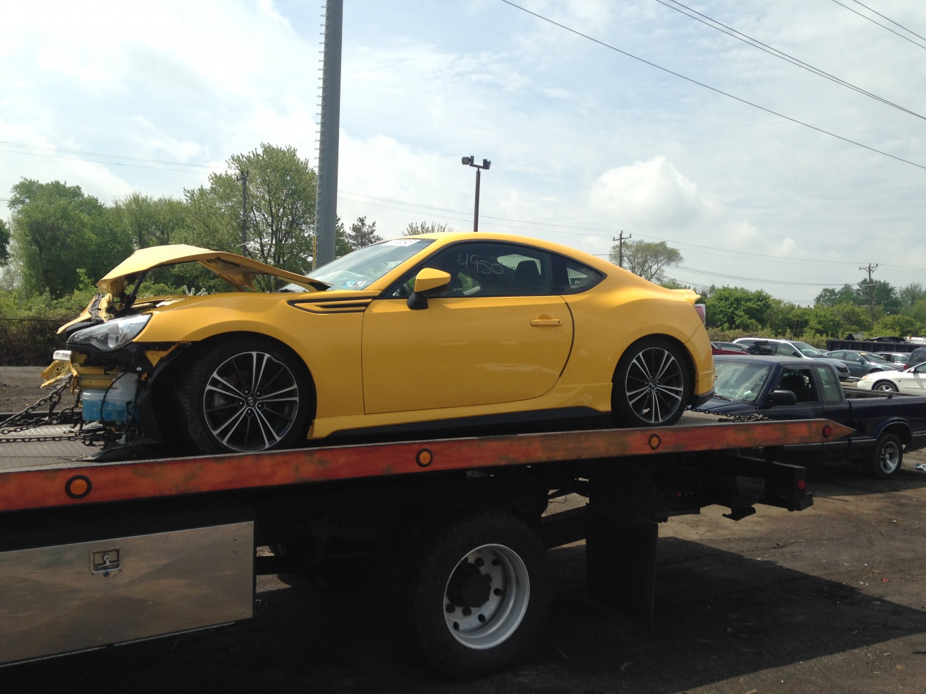

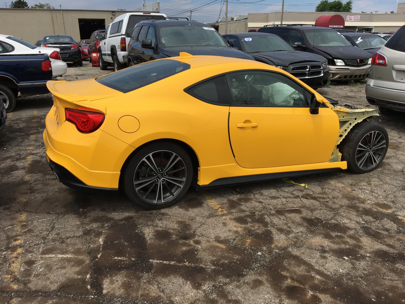

Here is the car when it came. Front end is gone. I never knew what a Release series was until after buying, I just thought it was a yellow painted FRS.

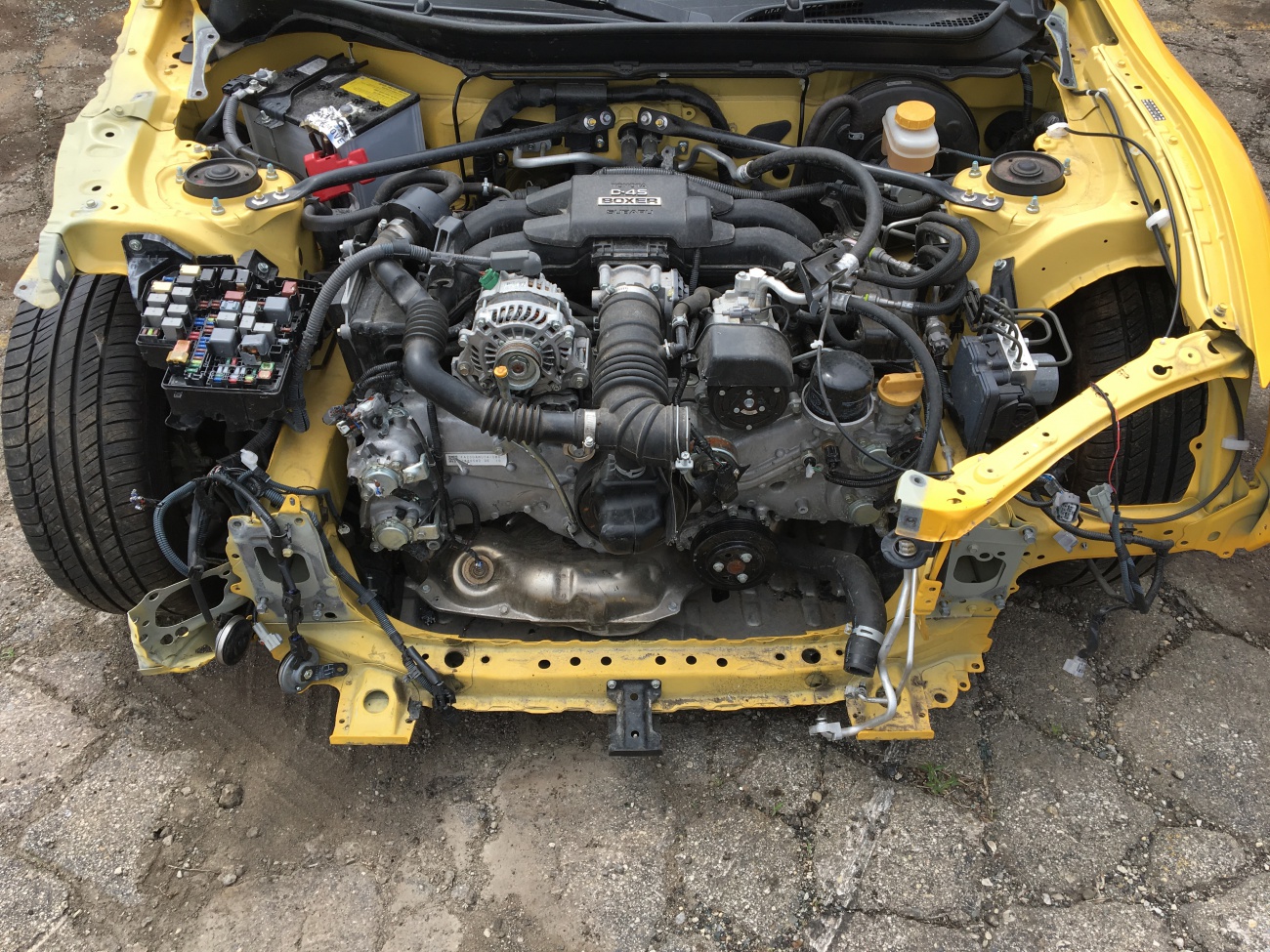

After taking everything apart, obviously the damage was more than I thought it would be. The timing belt cover was chipped, so that piece had to be replaced. Not to mention the frame damage.
Car was straightened out mostly fine though.

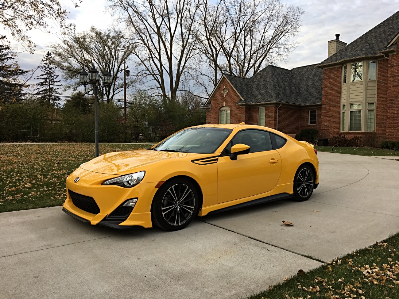

Here's a nice pic of the car before any mods to come. I sold the red one and made this my DD
