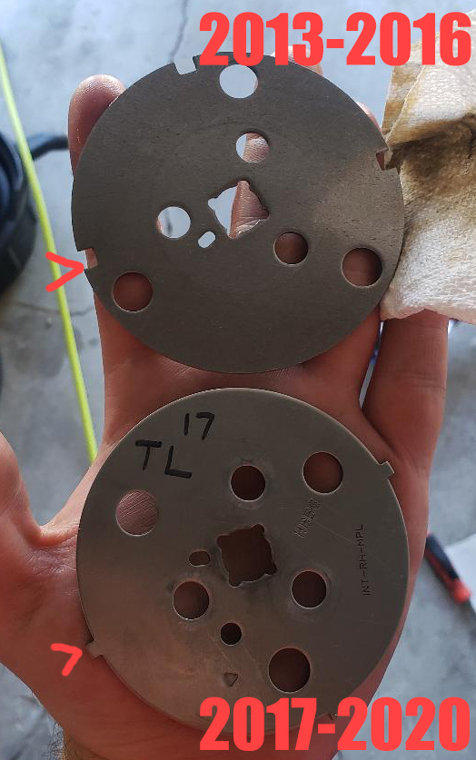

I recently installed a 2017 A/T engine (black manifold) into my 2016 a/t brz. I transferred every single sensor and the complete wiring harness from my 2016 engine, to my new 2017 engine. The car starts and runs okay for a minute but then gives me P0011 and P0021 CEL (timing over advanced) Do i need a different tune for the 2017 engine to run correctly?
No, you need to pull the front cover off and swap over the cam trigger wheels off the older engine. Each wheel is specific to each camshaft. Turn the engine over by hand until the triangles face each other before swapping. 3 inverted torx bolts each, sorry I don't remember the size off the top of my head. I want to say they go to 12-13ft-lbs, but, please double check.
Attachment 191142
You dont have to take the cam gears apart, you can simply switch the cam gear itself.
Yeah, I was just thinking if he was going to be doing it with the engine in the car still it would be easier to just swap the wheels themselves. That way he doesn't have to mess with the pulling the chain and messing with that bit, saving a bit of time.

Originally Posted by D-VO View Post
I wouldn't chance it because I'm not 100% certain. However, I had a Subaru technician directing me through most of it who told me I need to, so I trust him. It's something about the sensors that I inside the cam gears.
EDIT* okay just had a chance to talk to him again. He says;
Plastic manifold 17+ engines will bolt right up pnp but aluminum intake manual trans engines need to swap cam gears and trigger wheel. They send a completely different signal.
Subaru technician said 17 plastic manifolds dont need to swap cam gears though, thats what im trying to find out before i pull timing cover off
Pull one of the top cam sensors out then, peek through the hole. That should tell you what you have at least.
