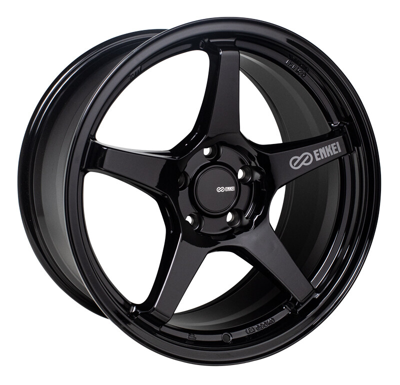

18x9.5 Enkei TS-5 5x100 +45
Will these clear? Did search but didn't see these listed. My car has coilovers, so that issues there.
ALSO... Is there an 18x10 +43-45 lightweight wheel out there that will clear the Brembos (other than going to a Forgeline, CCW build, etc)? Building the car to a class where size matters lol
