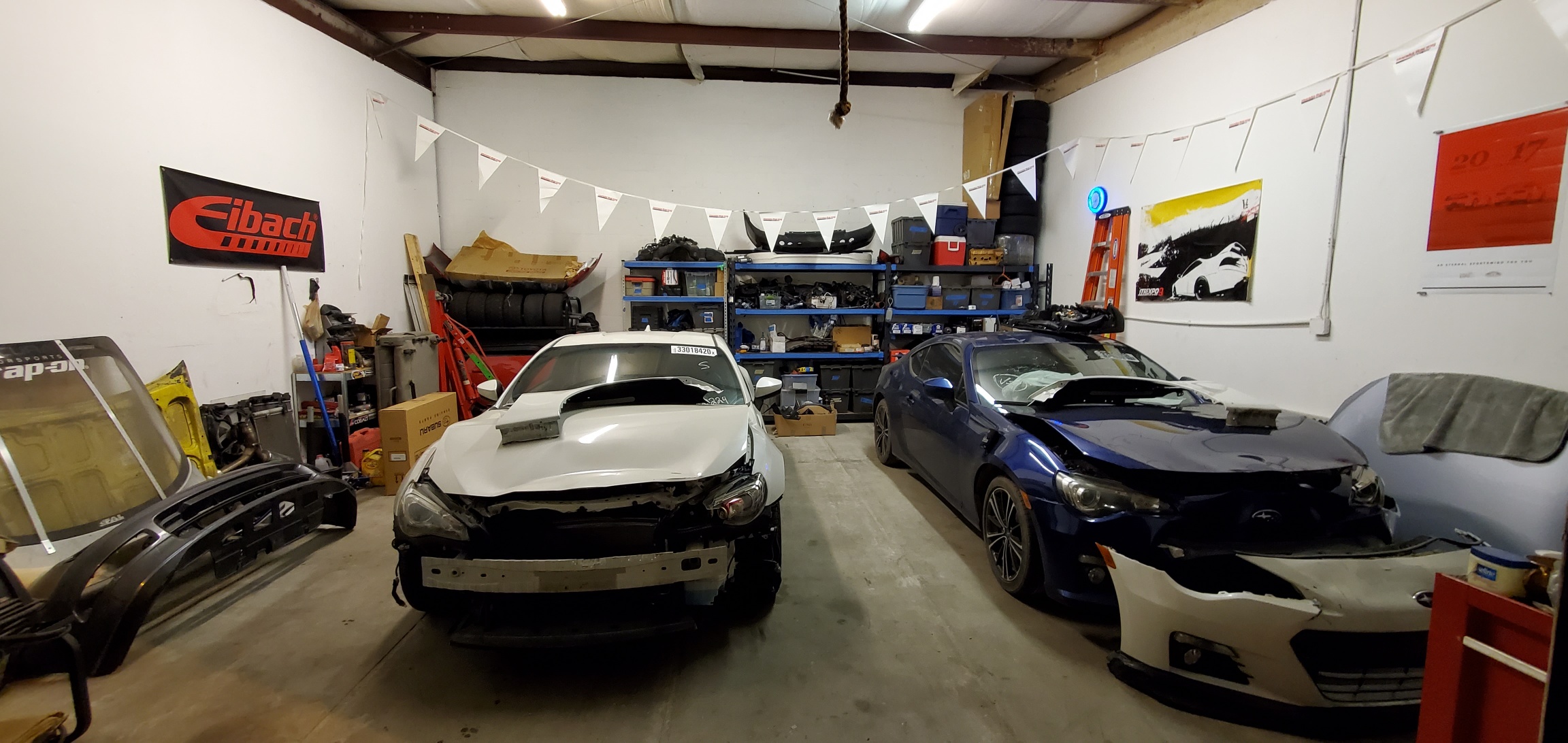

Hey guess what I did today.... yep bought another 2013 brz limited..
Its blue... but not wrb whatever the dark one is called. michigan car with minor front end damage hitting something high.....

One of these....

Organized the workshop a bit today and got rid of our old champ car racecar... now it's just a BRZ workshop I guess..
