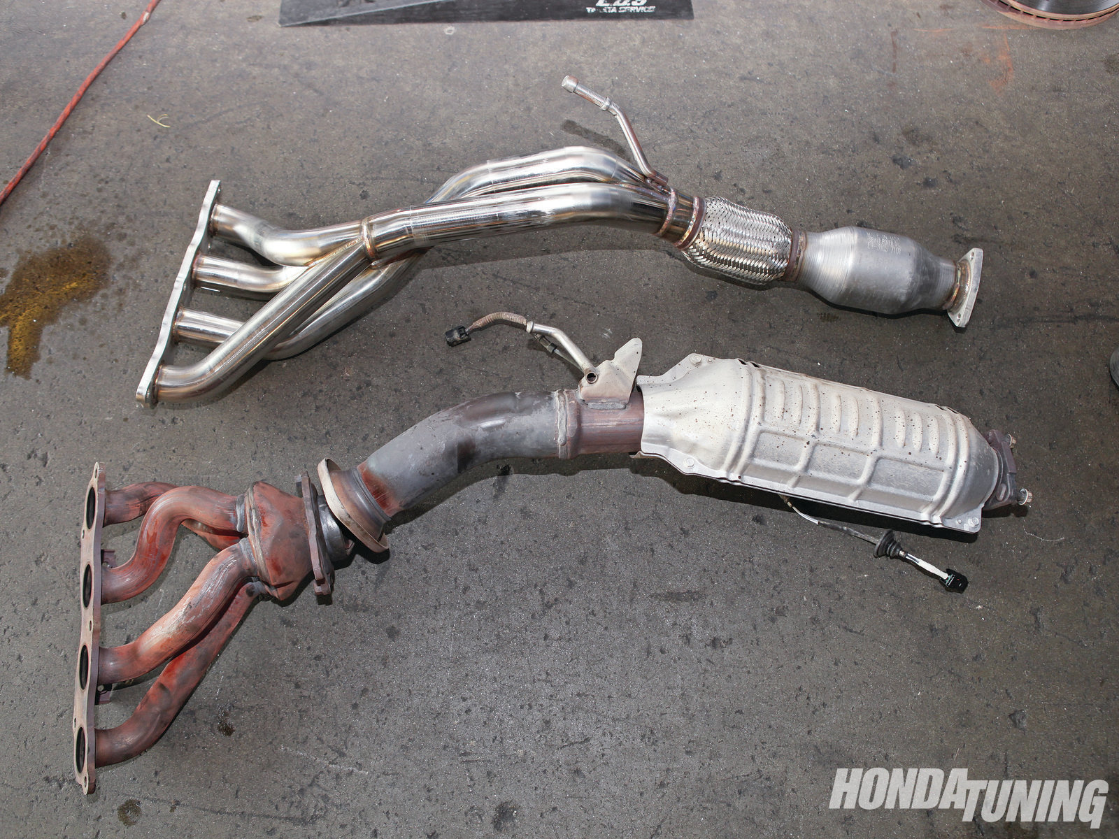

Well, it looks large, but it could be the same volume as our two cats, and it could actually be two cats with the o2 between, so it is all housed in one compact package. It is hard to tell by the pics. Our two cats seem like they would add up to more size that this single unit, but it is hard to tell without doing a cross-section of each.

The big thing is probably surface area. Most OEM cats have a denser core, but I'm sure some are better than others based on materials.
Stock:
Performance/High Flow:
