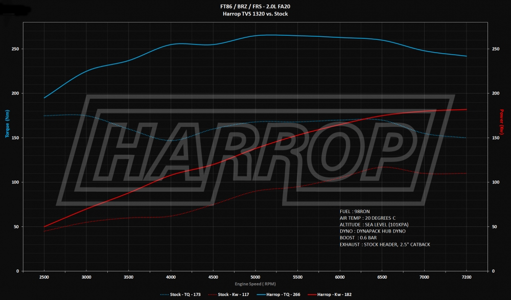

5. Quoted power on their website is available. They even posted a dyno:
first of all thank you for your reply
I studied all the content on the their website regarding this kit.
One thing i need to re-emphasize as that i'm stuck with 95RON = 91AKI (US) fuel ONLY!
this graph and all their numbers are generated using 98RON = 93AKI (US) octane fuel.
add on top of it the very hot weather most of the year
Hence, I have concerns regarding both reliability + power gains.

I use 91 or e85 or a mix. 93 octane is limited in many areas of the US.
It is likely that their Aussie emissions tune is conservative, meaning that the timing isn't advanced in an aggressive way, nor are the cams setup aggressive, so it easily passes emissions. With that said, the tune is probably done on 93, so they could maximize the power for advertising and so the car is capable of taking advantage of 93 octane when it is needed.
What do I mean?
I am not a tuner, but I'm pretty sure most tuners create a tune that is smooth and balanced and then they slowly advance timing and other perimeters until they start seeing knock then they back off timing to a safe spot. That timing position is then the max. The tune will retard timing when necessary, which will likely reduce power. Add 87 octane on a cool night while cruising and doing a few pulls, and there may be no need to retard timing. Go on a hard canyon run on a hot day with 93, and the tune may retard timing.
By tuning on 93 vs 91, the tune can advance the timing higher if the conditions allow. This might seem dangerous like the tune will go beyond what your engine can tolerate on 91, but it isn't. The computer can retard timing very fast, and it does this dynamically. Plus, you have supporting mods.
Here is a dyno of 87 vs 93 on a 400+hp Mustang. You could probably expect 2-3hp difference between 91 and 93 on your car.
