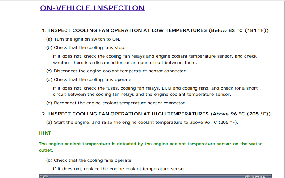

So I've had a read in the service manual. I think I might have found my issue. It is in fact the temperature sensor...
Name:  Screenshot from 2020-02-18 21-48-39.png
The bottom warm up test fits my description perfectly..
malkduds is offline   Reply With Quote
