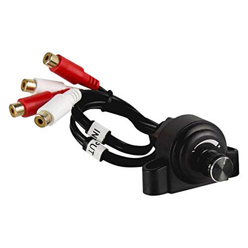

Something like this mounted somewhere on the dash or in the plastic ignition cover:
https://www.amazon.com/Install-Bay-I...ronics&sr=1-12
