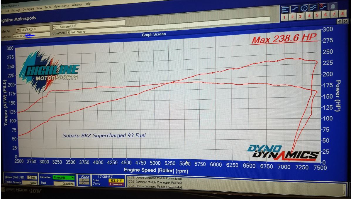

Took my car to the dyno yesterday for a few runs, and here is my best run. Not too happy about the results.. I did not however do a baseline run, so this is all I have to go by.
Supporting mods are Tomei Catless EL headers, Perrin 3" Cat-back, and Delicious 93 OCT tune.
According to my torque app, it peaked at 12 psi boost and intake temp was 95F. The car heat-soaks fast so we had to let it sit for a bit of time in between runs. We did 3 runs total, the last two runs were almost identical so we stopped there.
Happy to hear your thoughts on the run and what could possibly contributed to these results. I plan on installing the E85 flex kit over the winter to see if that helps.

Dyno dynamics generally read really low. Ask them what a stock 86 does on their dyno, I bet it is about 140 hp/100 ft-lbs.
What matters is that freaking flat-as-Kansas torque curve from 3k to 7k. Hard to complain about that.

Also, that's a 20% increase from straight stock, assuming it would read 200HP on the dyno (which it sounds like it wouldn't, so it would be more). I'd be happy with that combined with the improved torque curve.
@Chris3007 what does your butt-dyno tell you? That's what really matters.

https://www.e90post.com/forums/showthread.php?t=891691
Same car/same day. Dynojet showed 400 hp, dyno dynamics 325. So 1.23xyour hp gives you 293 dynojet hp. Feel better now?
