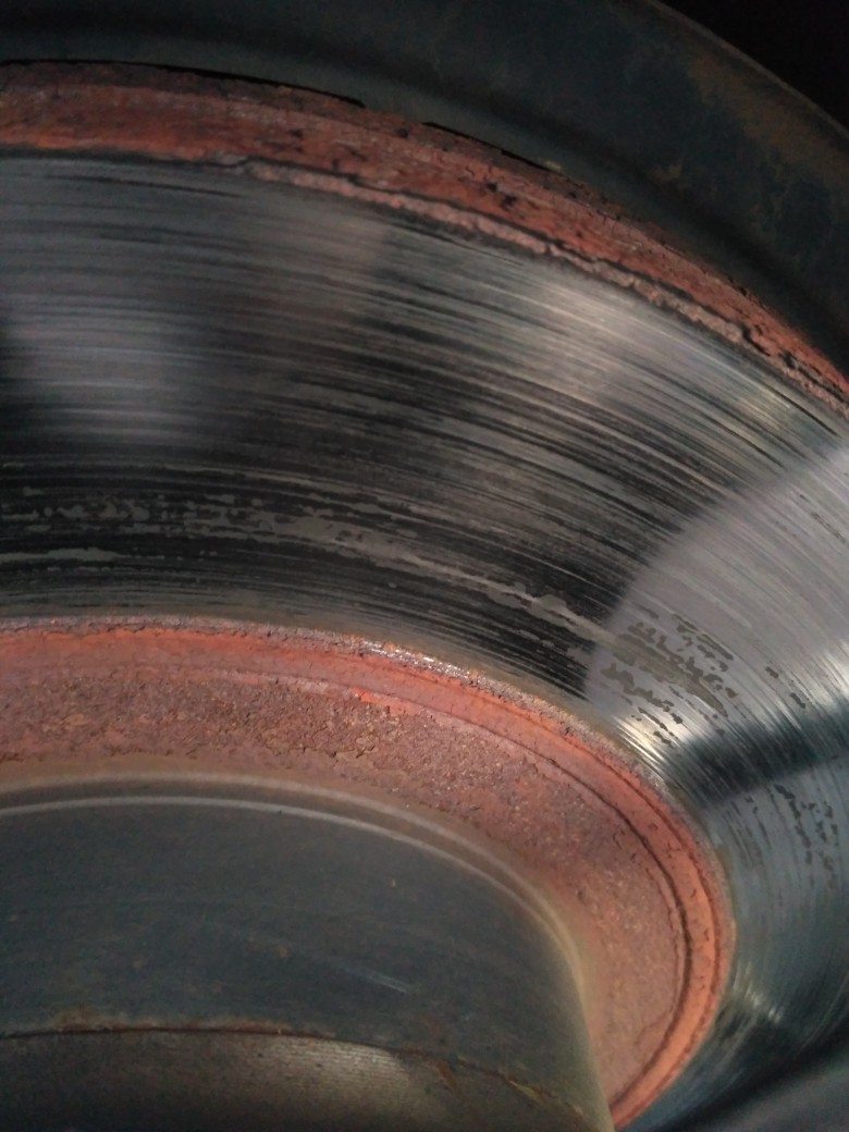

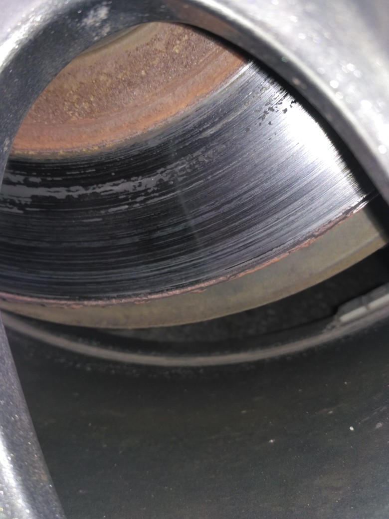

Are those brake rotors still good for a last track day?
They don't really have any gooves in them. But a couple of spots aren't shiny anymore. No cracks and no vibrations when braking.

Yes, but you DEFINITELY need more pad.

Thanks, what are you seeing on the rotors that make you say I need more pad?
I have carbotech XP8, and I didn't feel any fade during the 20 min sessions. My last session it was getting dark (evening), and i had trouble with the braking zone. I was braking too early (and not hard enough), so maybe that heated more the brakes, but I still didn't feel any fade.
I had an autoX yesterday, and that made the "matte streak" a bit worse. I have a track day (HDPE not autoX) next week-end, but the track is not that hard on the brakes I think (will be my first time on that track).

Just because you don't feel fade, doesn't mean you're not overheating the pad.
The XP8 is the most entry level of pads, and the streakign you are seeing is a result of overheating that pad.
You need more pad; spending a more up front will effectively multiply your pad life at this point.
