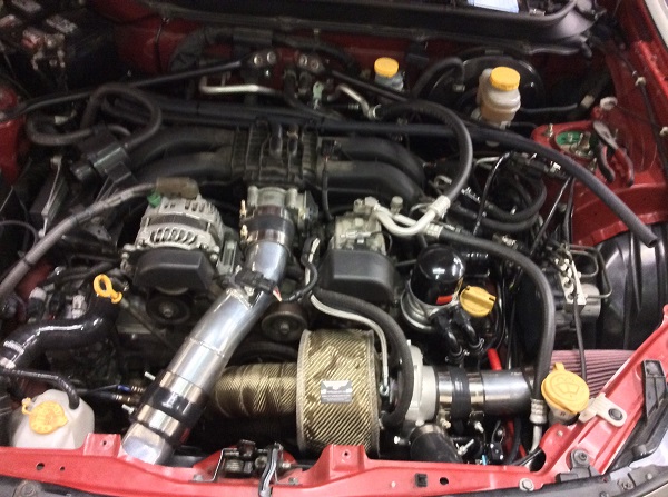

well not looking good... First start of the car resulted in massive clouds of burning oil. The AOS wasn't installed correctly but im not sure if thats the only issue going on... What eles could cause it to burn tons of oil at idle? Are the oil lines hooked up correct? Is the turbo just broken? its brand new...

I may run a GReddy kit on my car, but I'm probably more familiar with the JDL kit than most owners and shops.
Tons of oil burning? Check your vacuum lines and PCV system. You may be sucking in oil inadvertently.

Don't know if it's too late but, have you checked the turbo return lines? Also I would route the Verus AOS Vent to atmosphere, I have the same setup and never had any issues. You should check if you got any oil in your turbo as well, other than a cleanup job i don't think you should fall now man you have a lot in this build. This thread is packed with nice stuff you have on the car, don't give up dude

ok ok sorry I was stressing. Car is working. Just drove it and its great! We just had to fix the AOS set up. It just sucked a little oil in on the first start but it seems all good now. I will post a better update soon.

So its running now that we unhooked the AOS from the intake port. Two center hoses are now open. It looks like I want to connect them with a T-Connector and then just dump the open end out the bottom of the car? Or should I get a catch can? Verus has a recirculated add on also I could get... Also Im not sure what happened but my AEM oil pressure gauge has stopped working already? Drove it home from the shop and it worked fine. Pulled into the driveway and it lost power? Like it blew a fuse or came unconnected from the power or something?
