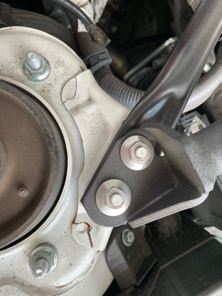

I have the Delicious flex fuel kit ready to throw in my car next weekend and I have a Grimmspeed strut bar also. I took the attached photo (ignore the dirt everywhere) when I went to investigate it myself after reading this thread. I'll email some further photos through to Delicious tomorrow.

A quick update. The flexfuel kit can be made to fit with the Grimmspeed strut brace. On American cars with your quick release fuel lines you may have to play around a bit but on my Aussie car all the lines work fine. Its a bit tight but it fits.
I did something similar with mine and the Grimmspeed brace.
I enlarged one of the mounting holes and used it to mount it to the car. The fuel lines are a bit tight, but nothing's kinked nor leaking.
However, once the Hotchkis brace is back in stock, I'll probably swap out the Grimmspeed for it since it retains the angular shape of the OEM brace allowing you to mount the FF sensor diagonally as designed.
