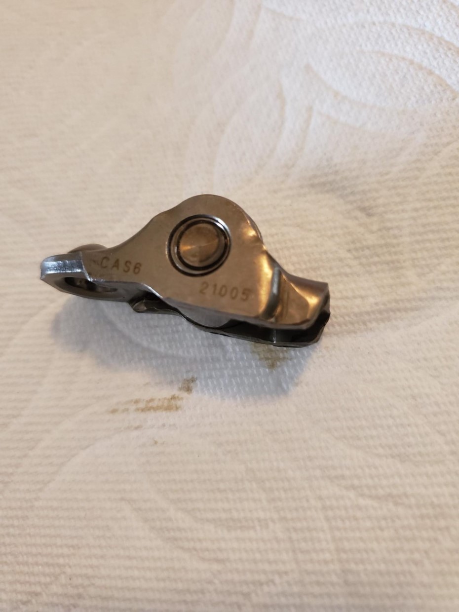

I can see how it fell out.

What am I looking at? It seems to be in one piece. Are you saying you "can't" see how it fell out?

Well judging by his picture it doesn’t look like the roller is detached so I guess it’s something else. Having one pop out without something breaking is a good trick.

So that roller bearing is supposed to be thin on one side.

I can’t make much out from that picture. It sort of looks like it’s off center if that is what you are referring to. The picture is kind of blurry.

That looks like an intact rocker arm, they are held in place by the spring pressure on the valve stem. I have seen them float around at high RPM or with a broken or week valve spring. To have one come out of position almost always means a broken spring. And Usually you would have the piston hitting the valve.
