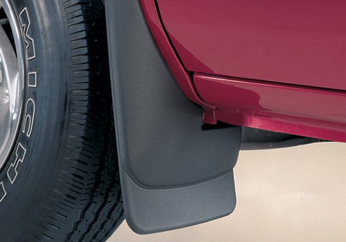

Here ya go -
humfrz
Old 04-29-2019, 09:09 PM   #7
Here ya go -
humfrz
I spend half the year driving through road sand and rock salt (1,000 times worse than sand) and behind my wheels are the only section of my car that are 100% chip free.
Why?
Because the Canadian cars all come equipped stock to deal with this issue.
humfrz (04-29-2019)

I actually installed those on my car a few years ago. Going to 245 tires with offset wheels for a flush fit seemed to cancel out the benefit of those.
