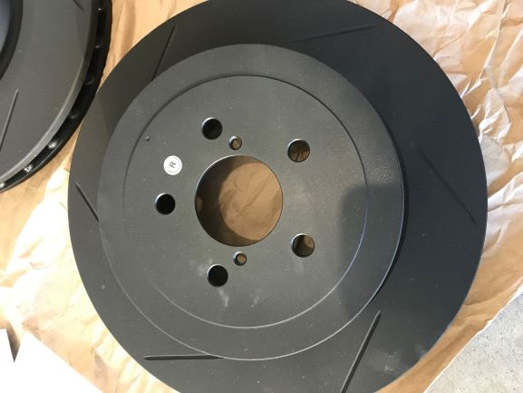

What have you guys done to prevent rust on the front rotors? The inner areas that the pads don't touch have a ton of rust after a few months.
Looking at VHT Caliper Paint, but I'm open to other recommendations.

It's rust! All brake rotors rust. They will Rust immediately after washing your car if you don't drive it within 2 days

Looks like they fixed the rust issue by leaving the outside painted, so the rotor will be protected where the pad does not make contact.
Attachment 176894

Well, I'm jealous. After two attempts at painting mine, I'm finally happy with the result, but the process was a pain. I'll see if I can post pics later.
