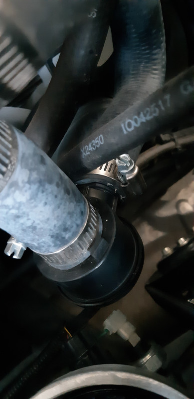

Originally Posted by mrg666 View Post
Just fix the valve installation immediately before causing any surge damage to the compressor and check how engine is running at idle. If you get rough idle or a check engine light, you can get another revision of the tune ... I think
#Done.
How it was:
How it is now:
Car drives, no CEL. Idle is good, but when wram, it bounces just once and then stabilizes. Maybe I have to give the ecu some time to relearn values. However, I think it has a little more boost on mid revs than before but loss of boost at the higher end. Rev bounces when letting go the throttle after acceleration.It goes down hitting 800rpm or so. Then goes a litlle up just to not stall the engine and then stabilizes arround 900 rpm - 1k. I will probably get a retune.
Looks as it should be. I would just send a data log to ask if there is any fix needed too. Enjoy!
