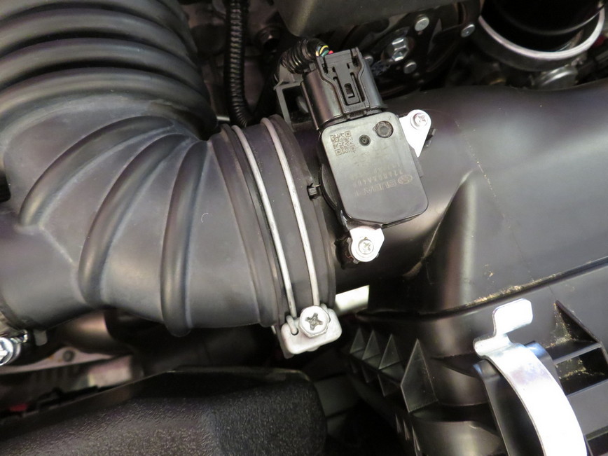

Check that the main intake air hose is secure. After installing the air filter mine had slipped off ~1/2".

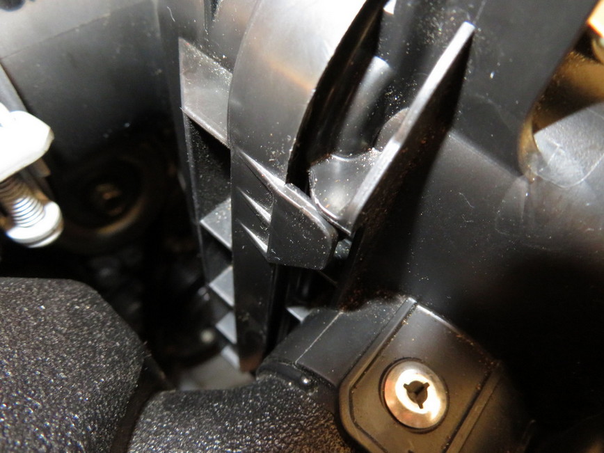

Wish I would have seen this guide earlier. Replaced the filter without unbolting anything but blundered by snapping off one of the teeth (clip? See picture) That it rests on at the bottom of the box.
It still appears to be "stable" but should i be worried and try to get a replacement?

That tooth you snapped off supports the bottom of the cover helping to hold it in place to the other side. You still have one more tab, but there is a chance you could not get a good seal since you broke one of the bottom tabs.
I would personally get a new airbox, but i wouldn't panick about it and not drive car. You should feel around and ensure you have a good seal and no gaps tho. Perhaps duct taping the bottom or something would be a safe bet to ensure there are no air gaps. You should be able to pick one up a used air box for very cheap. Used, stock parts on this car are worthless despite what everyone is actually trying to sell them for...Just offer someone $20-40 for their stock box at most or perhaps someone will just give you one.

Not sure if someone mentioned in this thread but the trick is to kinda "torque" the left side of the air box a bit when trying to get it back in place after replacing the filter. There is no need to take apart anything to simply replace the air filter unless you really desire to.
The key is to torque the one cover so that you are able to get the bottom lined up in each one of those teeth. It takes a bit of effort, you have to almost "contort" the blueish colored intake hose (on the left side) a bit to get some space so that you can get both teeth in. The system is meant to be very tight as to prevent things from getting loose or leaking over time. If you dont do this you will only likely get one tooth snapped in and you will miss the other one and when you try to clamp the 2 top clamps you may break that bottom tooth. Once you get those bottom 2 teeth in, you're good. The car will "tell you" if your good or not; if you are struggling to snap the two top clamps...you probably don't have both bottom teeth in. Once you know how to do it, its easy and you can do it everytime in a matter of seconds.
