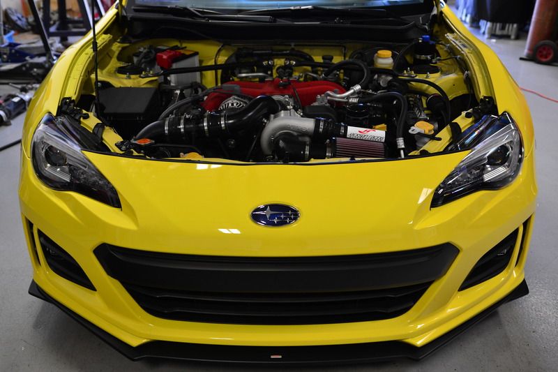

Originally Posted by J1Avs View Post
So you’ve done this exact install on a 2017+ w/ the JRSC Oil Cooler? Looks like you drive a 2016.
Yes actually. On a 2017 BRZ Series Yellow. C38 Kit with Track cooler.
