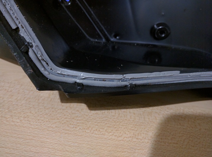

I took apart the "chinese" valenti v1 tails like I mentioned earlier. The sealant isn't your typical silicone sealant that most cars have where you just bake it open and pull apart. This one is more of a plastic type of sealant and won't get soft even if you bake it or use a heat gun. I had to use a heatgun and a pick/cutting tool to slice the plastic away to pull it apart.
Also, this is with a tail light that was damaged in an accident. I just wanted to see what was underneath.
http://imgur.com/a/kodfJ
Hope this helps anyone in the future.

Most taillights use the type of sealant that doesn't go soft with heat (unlike headlights). This means it's really difficult to open taillights without leaving severe marks. You could just cut them open and glue them back together later. Look for a DIY on opening oem taillights, process is similar

The set I had were sonically welded. Just to see how thy were wired I used a roto zip to cut around the edges. not very pretty and not easy to replace leds
