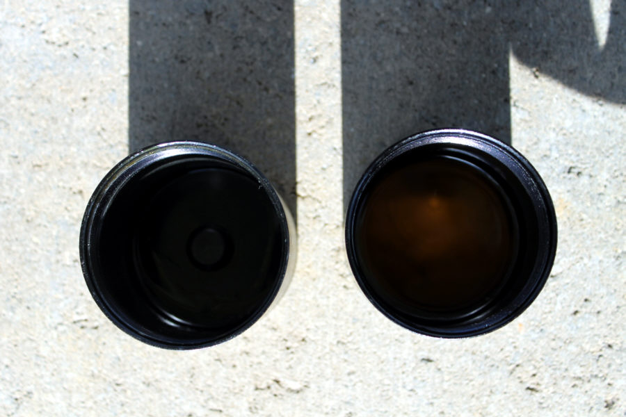

Time for an update on the catch cans. I installed a Mishimoto compact catch can each on a 2016 Cosworth BRZ and a 2015 WRX. I've driven about 500 miles each on these cars. On the left is the blowby from the Cosworth BRZ and on the right is a mostly stock WRX (has Stage 1 Cobb OTS tune). Now remember, the WRX came with forced induction, the BRZ did not.
Obviously the BRZ has significantly less blowby. The BRZ blowby, what little there was, was mostly oil with just a touch of water. The WRX blowby is a mix of oil, water and fuel. Mostly fuel. I would say that the BRZ is quite comfortable going forced induction and the Cosworth should not be an issue for this engine.
The BRZ has about 37,000 miles and the WRX has 77,000 miles. Getting this much fuel blowby in the WRX makes me believe I need to do a walnut blast on the valves sooner rather than later. Probably has incomplete combustion burn due to carbon buildup in the intake from the years of having no catch can.

the crankcase breather on the FA20 engine is generally very good and during our dyno testing we experienced very little blow-by
