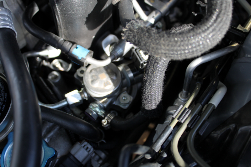

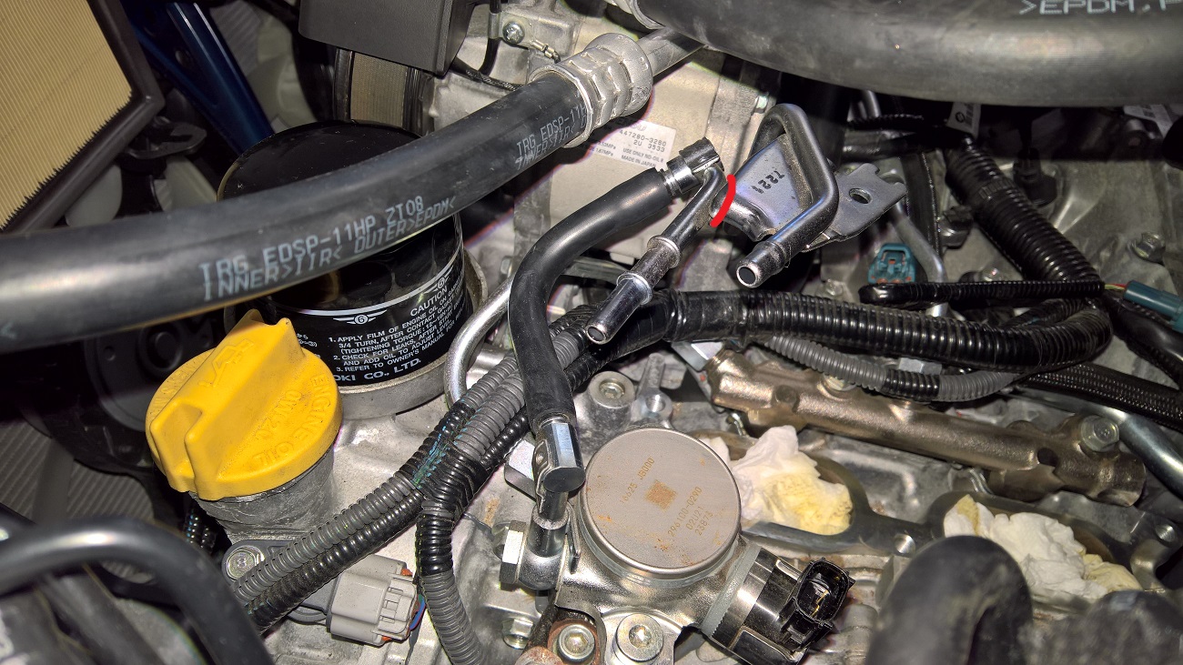

I finally got the Cosworth tune installed and verified that it runs!! Now that I've started actually taking things apart, I've encountered the instruction to cut the stock fuel lines, and I'm a bit hesitant about that, as I'd like to keep that connector if possible. To verify the part that you cut instead, was it along the red line that I drew in? Does the other quick-connect fuel line just attach back to the stock location?
Cosworth_0686 is offline   Reply With Quote

Here is the way the lines are intended to be attached. I just cut the fuel line itself and left off the quick disconnect. IMO dealing with hose clamps is more convenient than dealing with the quick disconnect that needs a special tool.
The GDI fuel pump, which is the metal one with the QR code etched in it, comes with a new banjo fitting. Use some washers and a hose clamp and you're done. The other fuel line goes to the manifold injectors. Again a simple hose clamp does the job. I've never had any fuel leaks.
yes that's where I cut
