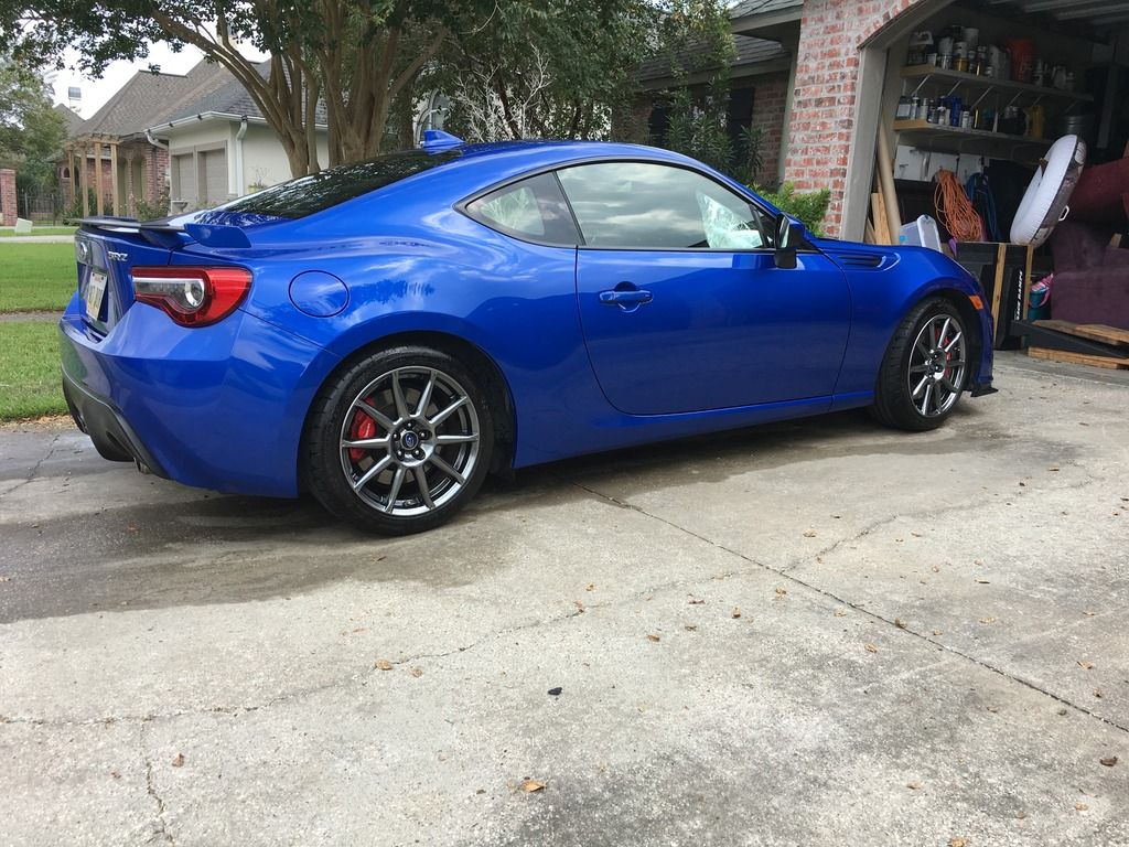

Old 08-25-2018, 01:40 PM   #35
Last Lemming Alive
Join Date: Feb 2017
Drives: WRB 2017 BRZ Limited w/ PP
Location: Louisiana
Posts: 97
Thanked 49 Times in 19 Posts
Here is a pic

Originally Posted by Last Lemming Alive View Post
That’s just what I’m looking for in terms of drop (OEM+).
Nice!
And thanks LLA!
Nice!
And thanks LLA!
Wait do you have different tires on your stock wheels?
Same size tire as it came with but Michelin pilot super sports
Makes sense and yes I can see a visual difference (beefier sidewall).
In what ways does it change driving?
Imagine less tail happy antics traded for increased grip and precision?
Yeah, that basically sums it up. Better ride quality too over the Primacy tires. So take that into account if just changing springs and not tires.
IMO the ride height is as it should have come from the factory. It looks right, and not like someone lowered their car.
