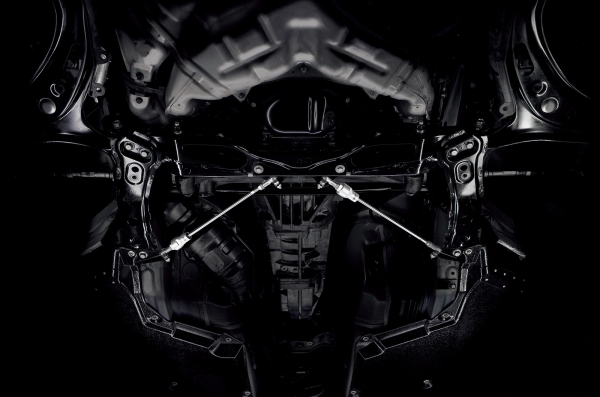

Here's the optional optional performance package.
https://www.sti.jp/parts/subarubrz_zc/
https://www.japanparts.com/
