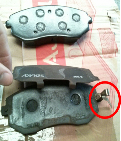

Still related to FERODO DS2500 brake pads, I've noticed that they don't have a metalic device like an "anti-blocking spring"riveted on it.
Is that ok ? The brake pads will not be frictioning "all the time" on the discs like that ?

That spring is way too weak to actually move the pad, it's just there to minimize squeaks.
