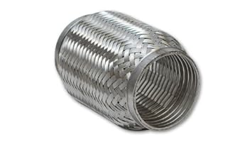

If this is collapsible then I would shove this in where the cat was like deploying a stent in an artery versus trying to weld in a pipe if I was looking to get better flow while remaining stealthy.

Cost is one factor. I’m not an advocate of removing the cats, yet regardless of my opinion, some may wish to remove the cats, but are afraid to run catless. Fines in California are really expensive. A way to reduce the risk is to gut the cat or weld in a straight pipe. Welding in a straight pipe won’t fool an officer looking for a straight pipe (maybe I’m wrong, maybe the heat shield would cover the section that was modified). A gutted cat would be about as stealthy as someone could take things.
Back to the mod, I wonder if boring the cat would be better to be able to press fit a straight pipe in the center. Basically leave the surrounding cat intact. Ideas?
