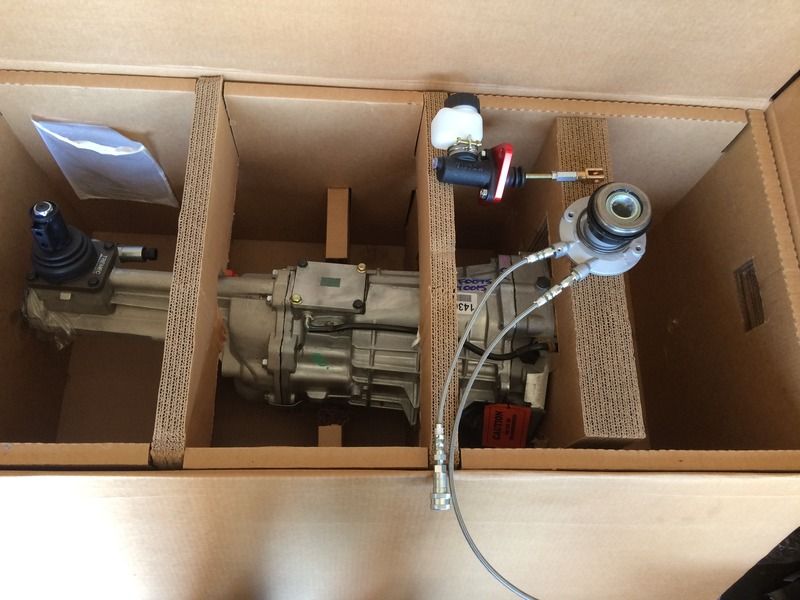

Originally Posted by ILLSMOQ View Post
And a Full Blown 8.8 rear end w/3.55 gears.
Almost ready to start tearing into it!
They managed to fit that in a priority mail box? Impressive

Hahaha. Nah it came fed ex...that was fromanothe shipment and I didn't want to damage the wood floor in my office!

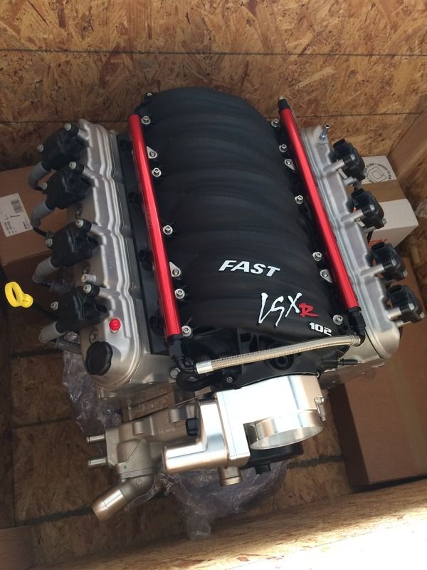

Two big boxes arrived this week!
Most of the hardware is here...looks like the Vorshlag headers have been redesigned and the ETA has been pushed back a bit...no biggie...almost ready to start in on the rear end.
