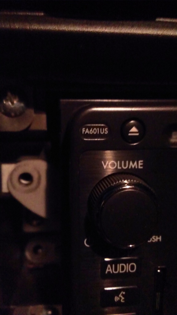

Originally Posted by SVXdc View Post
What is the model number printed on the front of your HU?
Can you take a picture of the top, showing the manufacturer's label? (that will have several model numbers and an FCC ID).
Here are the requested pictures.
Thanks!
Model numbers are different, but FCC ID is same as in 2012 Impreza. Means they're using the same BT module with a single FCC approval (not uncommon practice). Unfortunately, that means we won't get any new pictures or documents from the FCC's site for these HUs in other cars.
Originally Posted by noonanbobby View Post
Same unit in my '12 STI.
The various Fujitsu Ten nav units (2012-up Impreza, 2012-up Forester, 2013 BRZ, 2013 FR-S) all look very similar, but they all have different model numbers and a few subtle differences when you look close.
