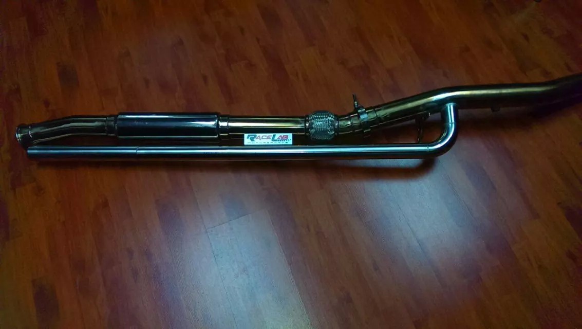

Think I might try this to help kill the drone. (Click Picture to read "How to")

Well. I cut up my nice Greddy exhaust to get me a nice single/center exit that I can use with a diffuser. Was going to use one of the mufflers from it, but the way they are designed with an offset outlet made it unusable.
Sounds amazing, except it drone horribly at 2k RPM. Right where I cruise at in every gear. So killing the drone with the resonator pipe is even more important now. I think I have found 2.1 feet is the length. I just so happen to have enough pipe to make one. So that will be done when I get the time.
Good discussion on making one and the example was spot on for us V8 guys with drone at 2K rpm.
Exhaust Resonance Tube
