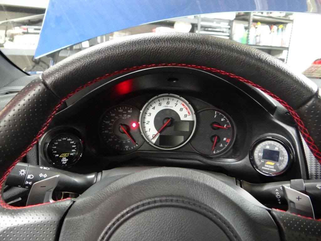

With this set up, do you need to modify to car to make the gauges fit or is it as simple as putting them in?
I had to dremel the plastic. My YouTube "install" video shows pics... IraceTV
